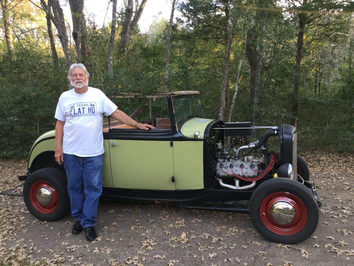

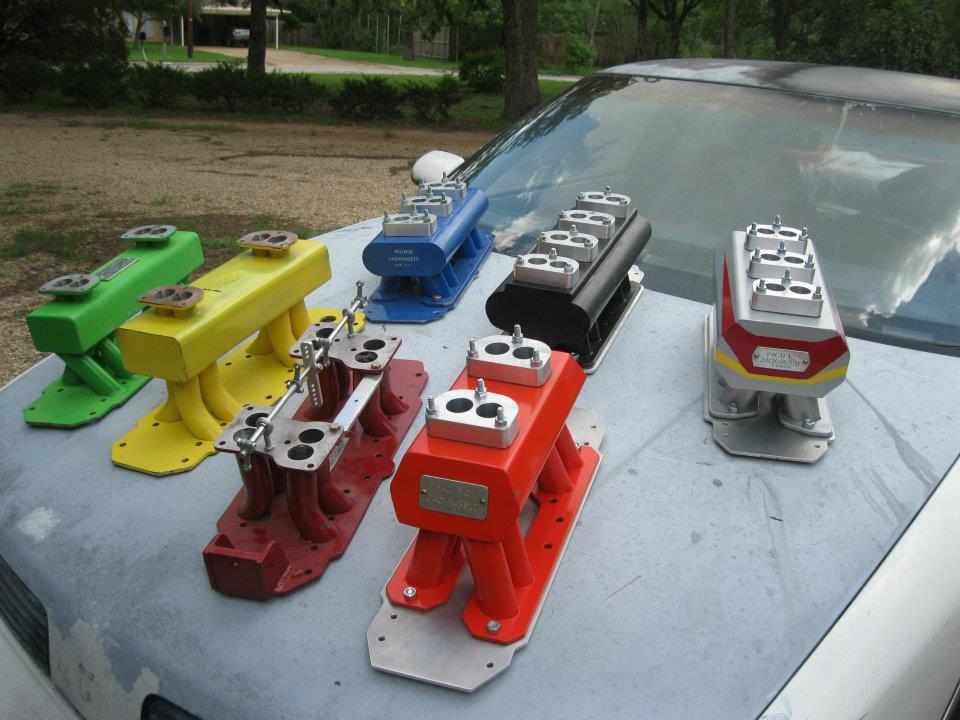

    76B5F477-353D-4105-8E7A-DE00D7A2DFEE.jpeg 20C2F12D-2B6F-4FCD-8C7A-DD994F293565.jpeg Congrats are very much in order. I am amazed you can obtain that much power running stock intake and exhaust ports. I am 70 years of age with 55 years of flathead experience And have always ***umed porting was a necessary part of the equation to go fast. My 32 cabriolet with 289 cubes runs 80 mph in the 1/8 mile. How can you run 6,000 rpm with a 4 1/4 stroke? You must have some very light valve train to pull 6k in high gear! Is the crank lightened appreciably? I ***ume you have a blower; what kind of boost are you running?
