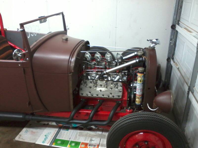

    Something like this? You can do it and if you think ahead and take your time you don't have to cut up the fire wall like a lot of people do. Put a 39 trans in it and you'll have a good old school set up. Or a newer t5

    Something like that firebrrat except the OP is trying to wedge a 8BA in a 29. I am currently helping a buddy shoehorn an 8BA into his 29 coupe and it aint for the faint of heart. And doesn't fit as nice as yours which BTW looks like it grew there! :D

    Yep! If you leave the radiator and grille where they belong (he has a hood he wishes to retain), you will run out of real estate before you get that 8BA in the engine bay. Also, the front stock cross member needs pruning to clear the crank pulley, the steering box needs to be moved (my buddy is installing a F100 box (possibly over the frame for more exhaust clearance), The headers will need to be custom made, and yes the firewall was m***aged...A LOT! And the heads will need to be bolted on, no room to lift the head off the studs on the left side.
    He may have got a tad aggressive with the cutoff wheel on the firewall but remember there is no intake manifold in these pictures. Its a tight squeeze but it will work. I would have reversed the firewall and ditched the tank but he didn't want to re-paint the exterior, his car his option.

    Here's one in my '29. Uncut firewall, radiator about 1/4 inch forward. F1 box lowered about 3/4 inch in the ch***is and some fab work on the fan/belt loop.
    As others said: yes '39 style transmission and closed V8 rear with a k style crossmember.
    Hope this helps.
