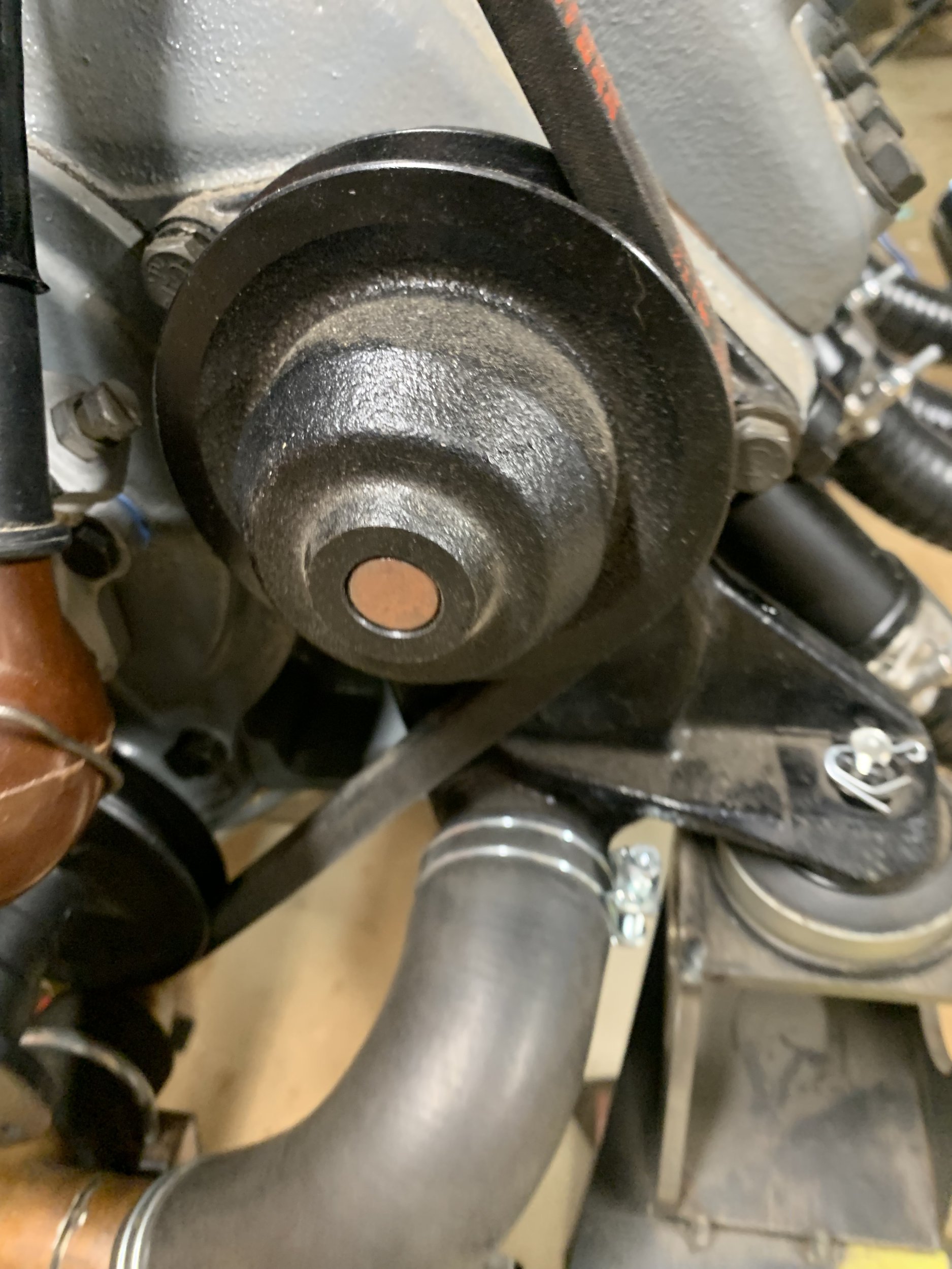

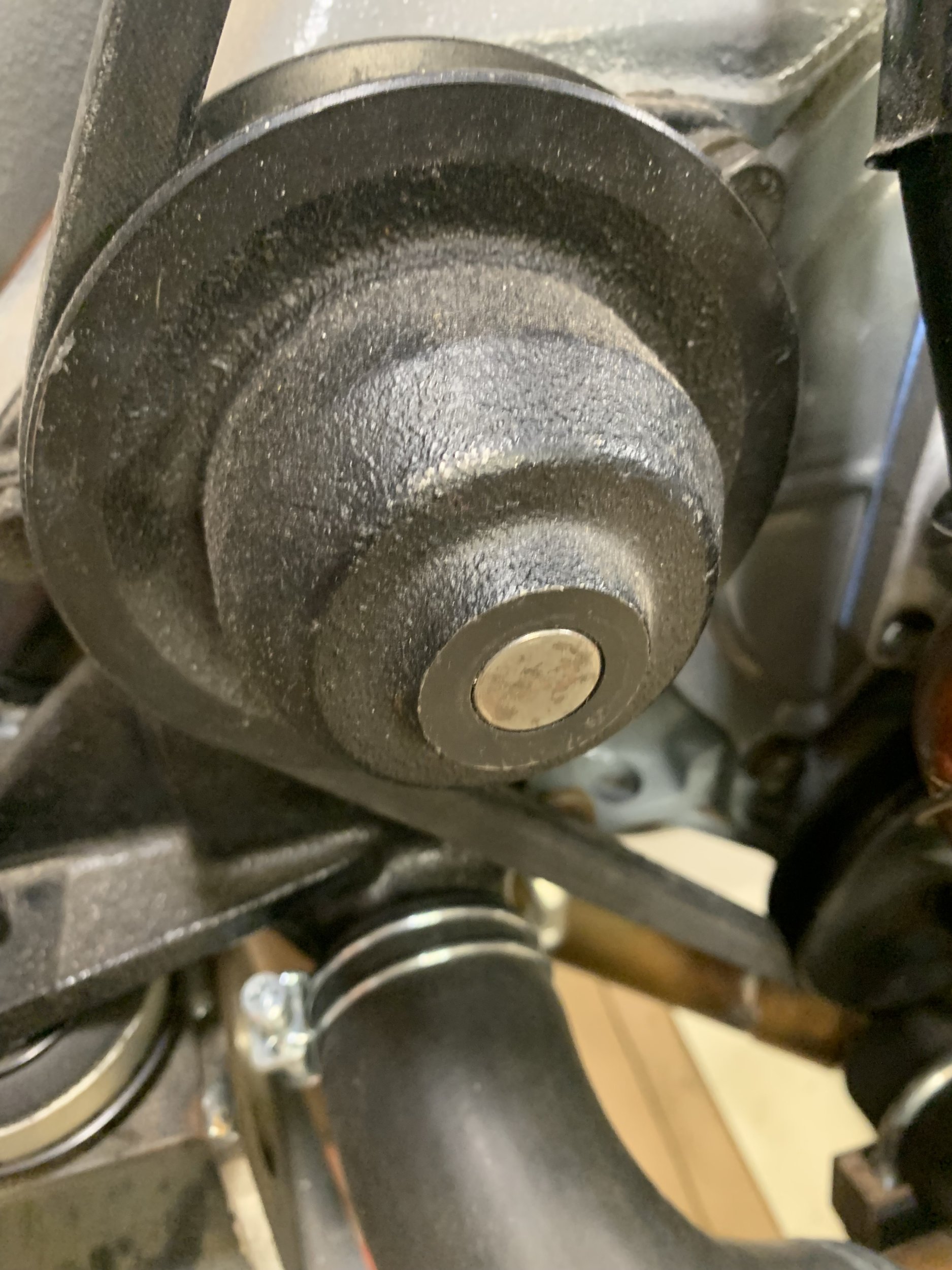

    After 8 yrs of blood sweat, and tears, I should finally be ready to fire up my C59A for the very first time tomorrow if all goes well. I just want to run the engine to break-in the cam for 20 minutes. I have no way of driving or putting a load on the engine right now to seat the rings.
    Just looking for any advice or pointers before the point of no return.
    Some background details:
    1. Engine rebuilt between 2021-2023
    2. Engine is stk except has a Isky 1007B grind.
    3. Generator, starter, carb, fuel pump, distributor are all rebuilt.
    4. Electrical is 6 VDC pos ground.
    5. Engine has 5W-30 Lucas Hotrod oil.
    6. Radiator is rear mount with electric cooling fan.
    7. Believe it has 180 F thermostats, and fan is tripped to come on at 190 F IIRC.
    8. Coolant is a mixture of distilled water and antifreeze 50/50.
    9. There is an oil pressure gauge, coolant temp gauge, vacuum gauge connector Ted to the engine (all hard plumbed). I’ll use a hand held optical tech to measure engine rpm.
    10. I’ll be moving it outside to start it up.

    Checked the coolant system. Pressurized it to 22 psi, no leaks. Then kept adding air and it spiked to 40 psi suddenly. Noticed drips at the front of the engine. Was leaking from one of the clamps. Had two other clamps leaking a bit as well. Tightened them up, and leaks stopped, but reduced pressure down to 20 psi. Will be back in a couple of hrs, and will jump back on it.
