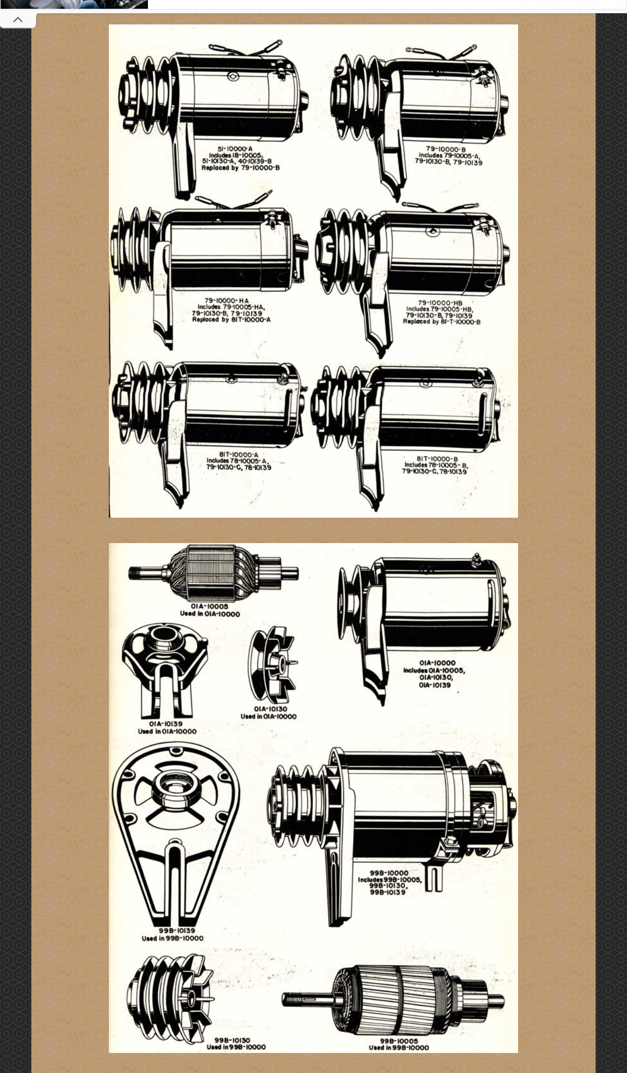

    DSCF2351.JPG If you walk past a pile of Flathead generators at a swap meet what do you look for? What are the details that make some more desirable, and different, did Ford stamp some code or part number someplace. Thanks!

    Depends on what flathead you are bolting it to. I like to match the front casting of the generator to the engine to make mounting easier. I work with 40-48 stuff mostly.
    I convert the 6 volters to 12 by swapping the housing and rear cover and armature from a 57 through early 60’s generator to the early front casting. Might take some pulley magic if you want a wide belt or need a fan mount though.

    I do the same as above, but when running a pulley mounted fan I like to start with a 39 standard 2-brush generator. They can be identified as they look like a 40-48 generator housing with no cut-out, but have a fan mount pulley held on with the larger 11/16-24 thread nut. The 32-38 3-brush generators use a small nut on the pulley and have the wires coming out of the housing for the cut out. (3/8"-24 I think).
    The 39 generator can be converted to 12v by using the 57-64 Ford field coils.

    External regulator generators with fan provision are the unicorns I look for.

    Easiest way to identify is that it has a stud on the body (like every flathead external regulator gen) and the pulley has 4 holes in the front of it to mount a fan. Will have single or dual pulley. There’s some other small differences but that’s the easy way to tell.
    There are a few versions of it that could be 39 standard 85hp or 60hp or truck and industrial IMG_8309.jpeg IMG_8311.jpeg
