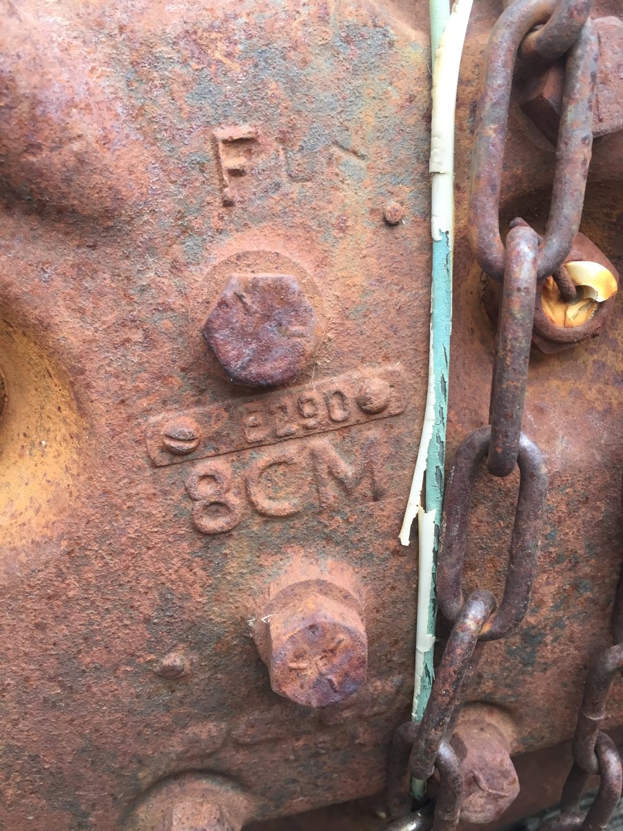

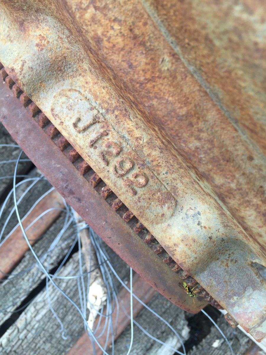

    Ok so I'm new to this forum. But not new to forums haha. I'm sure I'm posting this in the wrong location but I do need help you guys. I've picked up a Flathead engine with a bunch of parts from it. Came from my good friends Father in Law Dan. Dan's father had this truck and he ended up p***ing away many years ago. After his death Dan pulled the engine from the truck in hopes to do something with it. 30+ years p***ed and nothing ever happened then I asked about it. Here is the question... I have been doing as mush research as I can, and all I'm coming up empty handed. Like I've said I'm new to "This Forum". The heads are Stamped 8CM and the Block above the Bellhousing is stamped J1292,

    Heads are Mercury, '49-'53; (not positive of the specific year, but the 'type'.
    These Mercurys had a 3-3/16" bore, and a 4" stroke.
    Is the original flywheel attached? Are the clutch cover bolts evenly spaced (Borg & Beck; Mercury) or in 3 pairs of 2, the 'pairs' being about 3" apart? ('Long' drilling pattern; Ford)
    If the engine is a Ford, the stroke (piston travel from top dead center to bottom dead center will be 3-3/4". Bore will be the same as Mercury.
    Just for further i.d., take a rag soaked in gasoline, and rub the engine block where it is painted...if it's factory green, it's a Merc. Blue or red, it's a Ford.

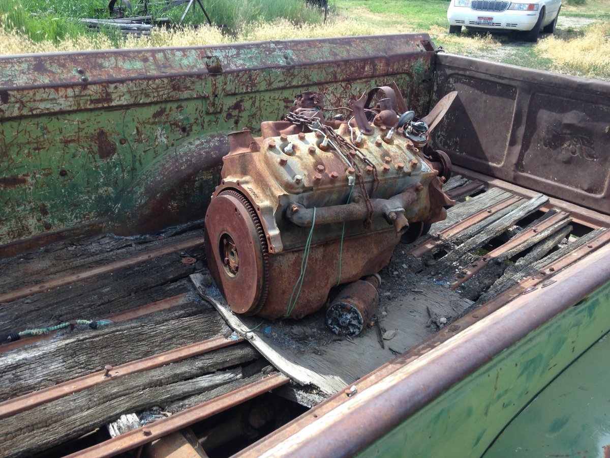

    Here are some pictures to help out

    it's a late model (49-53) with that short rear end of the block.
    http://www.vanpeltsales.com/FH_web/flathead_specs-90to125late.htm
    btw the numbers you said are 'stamped' are really "cast". For an example of a stamped number, look at that rebuilder tag, the numbers on it are stamped. No biggy, it just makes communication easier if we all use the same terms to mean the same thing.

    Good call on the ''Stamp and Cast''. Seems to me that's its a Late Model Ford Block and Late Model Mercury Heads according to you both. Huge Help!!!
    The engine was rebuild in the Late 70s according to Dan. its been punched over .030 over so far but I know its going to need to be punched over more since the pistons are stuck due to rust and weather. Whats the max you can punch it over on those late model engines? Flatheads are all new to me and I'm doing as much research and reading as I can these past few days.

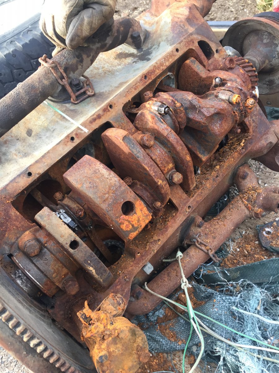

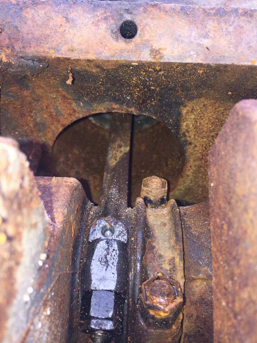

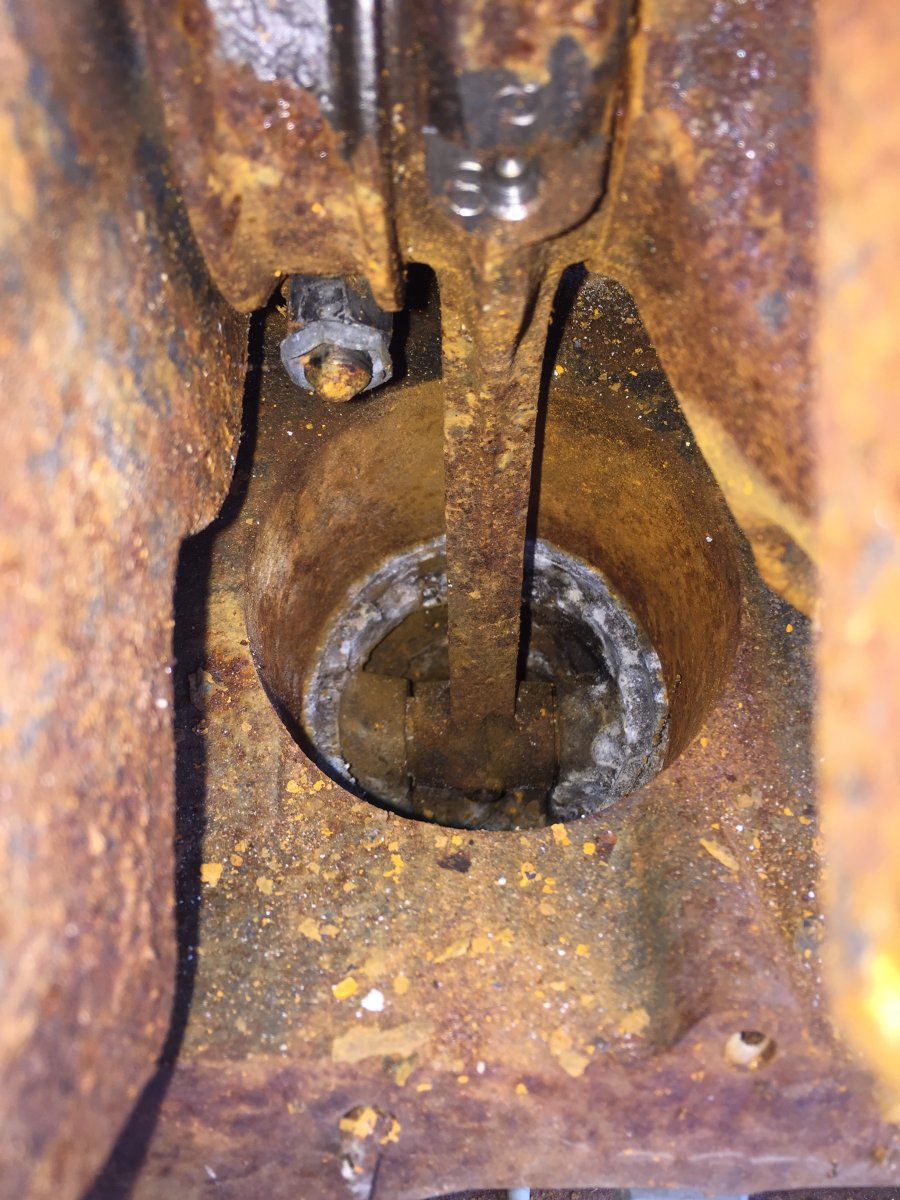

    Here are some pics of all the rust and weather wear over the past 30+ years of it sitting.

    yikes...be careful not to crack the bores when you take the pistons out....sleeving costs more than overboring.

    Yeah its really bad. I think I'm going to soak the block in diesel fuel and let it sit for a few days. Or try water and rust remover. Once I pull it out I'll hone the cyls and try and get it as smooth as possible so when I push the pistons threw it hopefully wont score the walls that bad. What do you think?

    I took apart a really rusty engine once...the pistons swell up as they corrode, so they don't fit in the bore any more. If I had to do it over again, I would have tried to drill/saw/break them before trying to pound them out. I dont know how successful I would have been, though.

    That thing had a lot of water in it. If the cylinder walls are pitted badly you are probably looking at sleeves. I ended up driving mine out from the bottom and busted more than I could save. The pistons will be a challenge to get out alright but easier than the valves. You are going to end up cutting the valves off and driving them out the bottom as well guide and all. I would certainly try to salvage the crank and oil pump. You need to soak that thing in a 55 gallon drum of rust remover.
