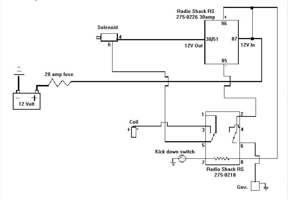

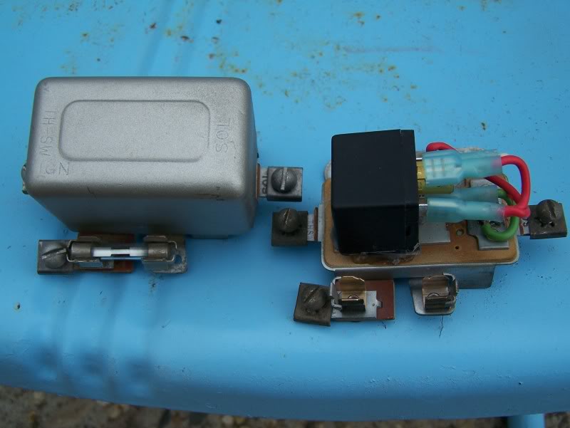

    Cable in is "overdrive engaged". DON'T pull it out unless you are STOPPED or you could damage the overdrive. If you are driving with the cable out, you can push it in to engage the overdrive. If the cable hasn't been used for a long time it might be stuck or very stiff so it's a good idea to get it loose and operating smoothly or get a new one. Check where the cable attatches to the lever on the transmission and make sure it pushes the lever far enough to completely engage the overdrive. When you park the car, shift to reverse and that will disengage the (free wheeling) overdrive, and set the parking brake for good measure. A new separate reproduction overdrive wiring harness is relatively inexpensive and can save some headaches if you have old frayed wiring. Solenoids can be expensive to replace and relays also. I have converted Bosch relays to work and the are cheap and reliable. Here's a wiring diagram for the Bosch relay, and you can put it in an original housing to hide it.
    Dan1982 likes this.
