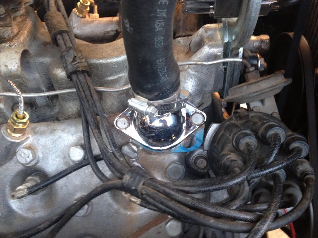

    So I picked up a ford shoebox with flathead v8 recently and decided to take it on a 60 mile trip to test out the engine after driving around town with no issues. After about 30 minutes in traffic. Someone said your car is leaking badly...I pulled over and coming out of the pressure relif/ overflow hose on the radiator was tons of coolant coming out fast....I undid radiator cap with a towel and steam came flying out everywhere....radiator had no visible fluid in it after overheat....I have o temp gauge because I haven't hooked up the gauges since the rewire.....I added water to the radiator and let it cool down......
    My buddy suggested checking to see if the thermostats got stuck or faild shut.....I took of and checked where I was told thermostats were and there were none. Like someone removed them....then he suggested hooking the temp gauges I have up to see if one head gets hotter faster which means one of the 2 water pumps may not be working.
    I just rewired and switched to 12v with alternator. Both water pumps spin and both belts seem tight so I'm not sure what could be causing the issue
    Before I replace both water pumps are there some other tests that I should do to find out what's not functioning properly? How do you check if water pump is not working?
    Any help would be greatly appreciated.....Thanks in advance....

    Ok so I believe it's fixed! Here's what I did...I drained radiator and installed 2 fail safe thermostats ( remember mine were missing). I then installed 2 separate temp gauges for each head. I filled radiator back up with 50/50 coolant bright green stuff. I tightened one of the thermostat housings and cracked it like a jackass. I freaked out went to pep boys and modified a chevy one!!!! Temporarily until I get a replacement but it works fine. It's for an early year Chevy v8... I ran car for a while and the temp never got above 180. On the passenger side head it got to about 200 and I freaked but them dropped down quick. I'm assuming first time the thermostat opened and coolant rushed into engine....after that stayed between 180 and 190 each side is pretty close to the exact same temp....In the morning I'm driving to a classic car meet up and will test engine a little more but I'm pretty sure not having thermostats was def the issue
