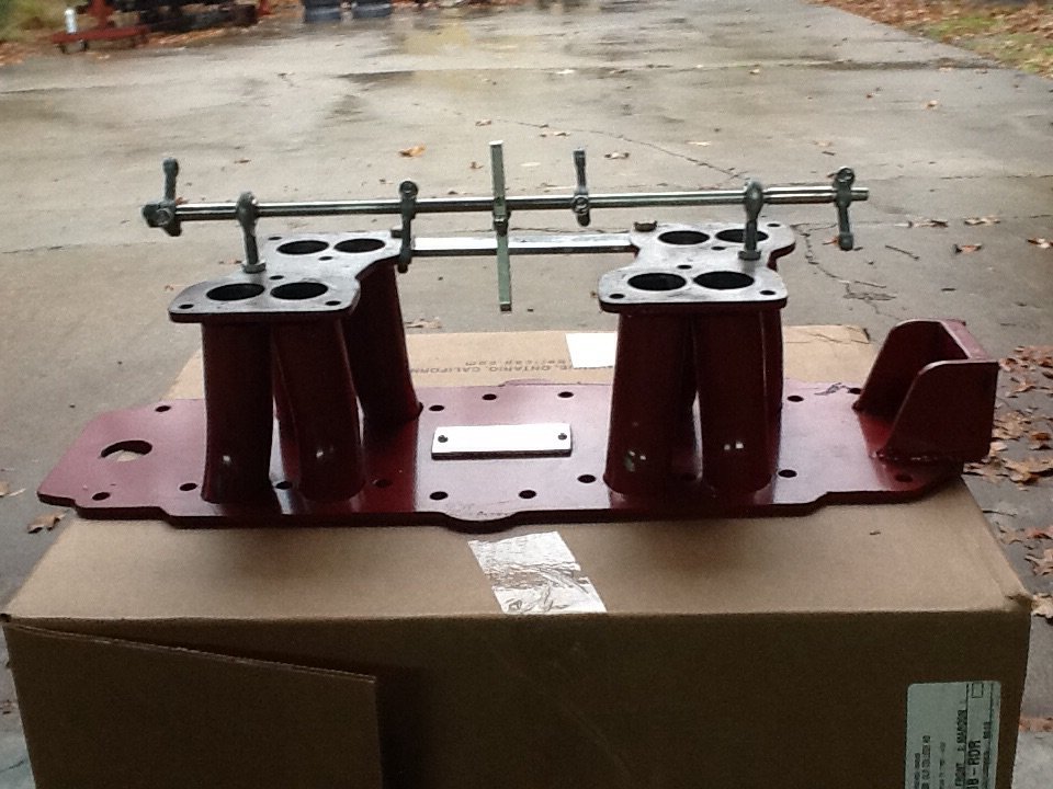

    image.jpg Looks very good. Here is one my friend made(not Webers) for 4 individual carbs; in theory each throat is individually tuned.Looks great on paper,untried in real world.

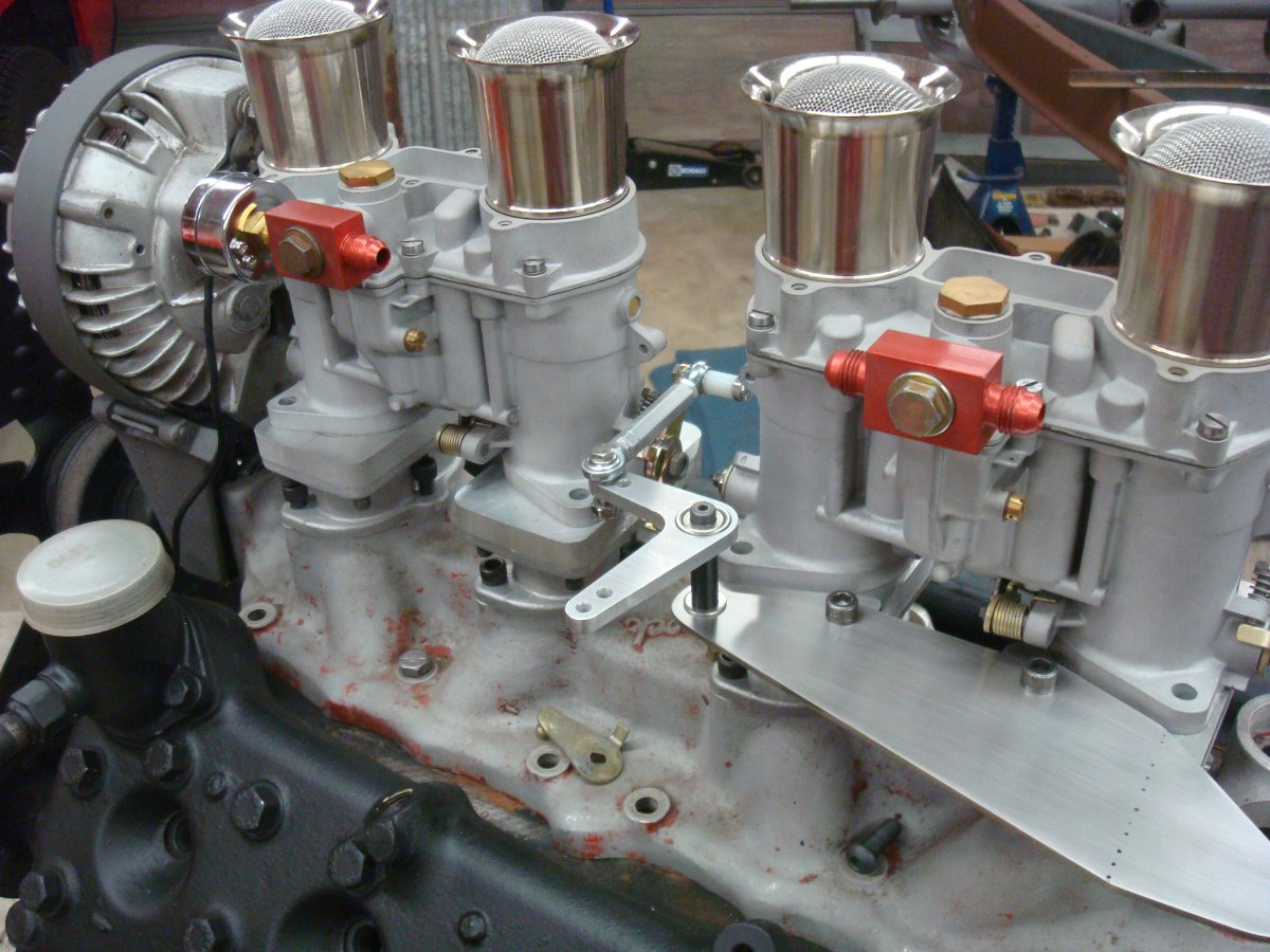

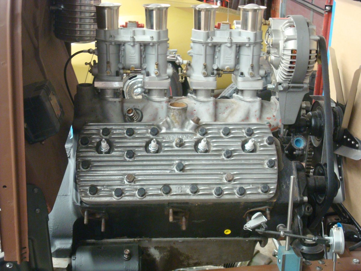

    Here's how I did it. It works but not any better than a couple of Strombergs, looks cool though under the coffee table.
