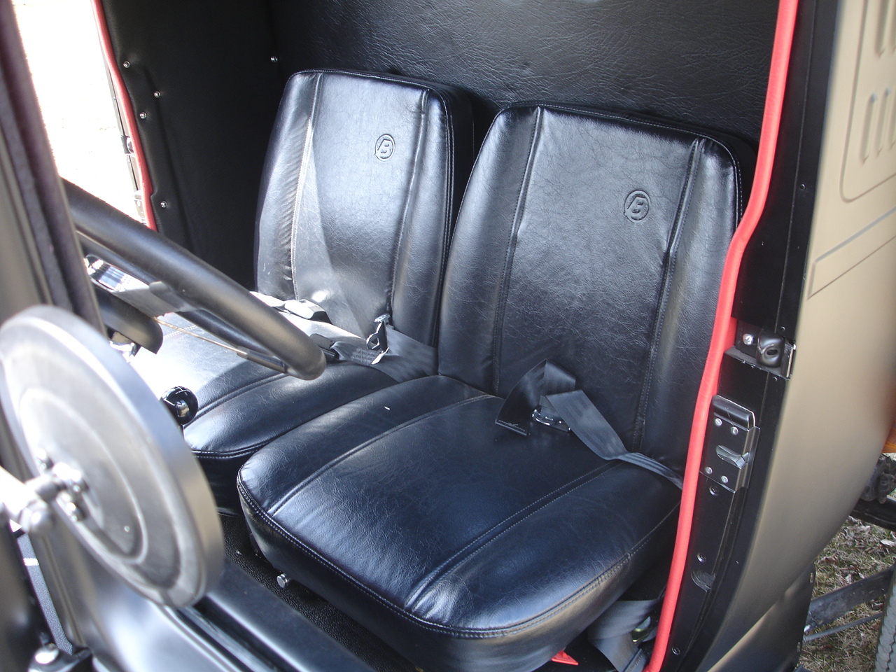

    95E32D8F-D450-4CA9-9A18-33383D2D844A.jpeg 8829AAEB-FD8F-4C15-8934-A677261D74A7.jpeg
    I'm 6' and found the '29 CCPU impossible to drive comfortably. The cab corners are stretched 6-1/2" and the CJ-5 seats have been replaced by CJ-7 seats that have a taller back.

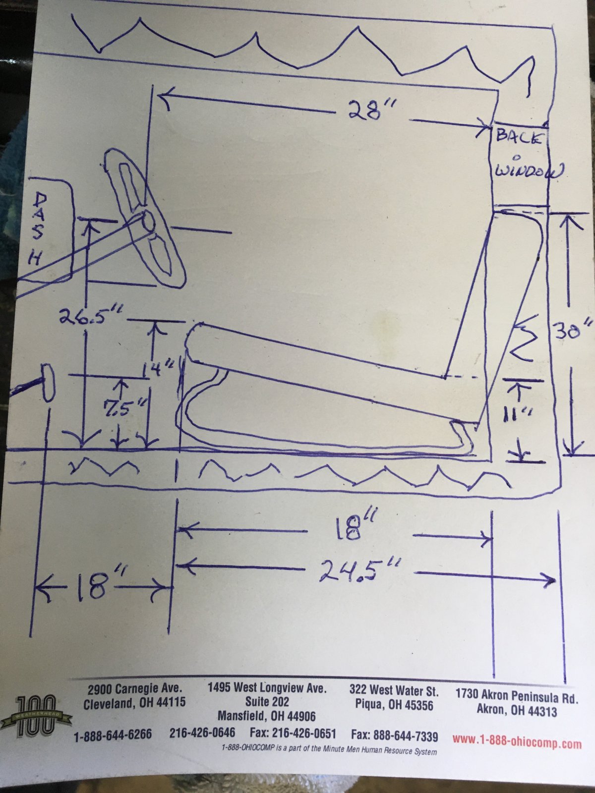

    You could also buy a 32 pickup and install a new 34 firewall for space.
    Here’s my 34 dimensions.
    I’ve added some pictures for clarification.
    Please excuse the rough drawing.
    A lot of the dimensions were taken from the door and floor opening edge.
    Let me know if you need any others.
    I believe the seat is the second or third seat from a 60’s van based on the tubing frame underneath. PJ

  15. Thanks @Petejoe. This is traction I can work with. I can mock up your measurements and figure it out to get me in the ball park. Hugely appreciate this.

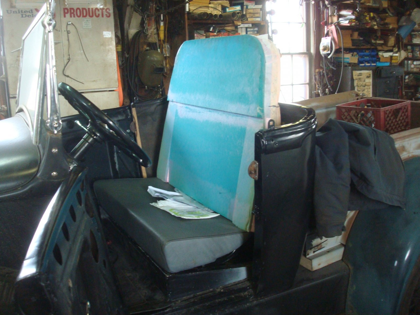

    You mentioned a sedan. I have a 1930 Tudor that is chopped 4". I am 6' and 78 years old. It is a feat getting in and out of. I have moved the seats back somewhere in the leg room area of the back seat and it is comfortable for the legs to drive, but I am looking out the top of the windshield and cannot see stop lights. I also have a 1931 roadster pickup. I removed the original seat and installed a school bus bench with the bottom cushion mounted directly on the seat box. With the back cushion push completely back under the body lip, I have reasonable leg room but I still need to be a contortionist to get my size 13s in. I don't know what I will do when I get a top, but I wouldn't trade it for any thing.. My buddy up in Haida Gwaii has a 1928 closed cab pickup that he drives all the time. He is 6' and has mastered entry and exit. No matter what , they are all small, so try before you buy.
    This is the only picture I have right now. The top of the seat has been removed and the seat moved back 1.5"

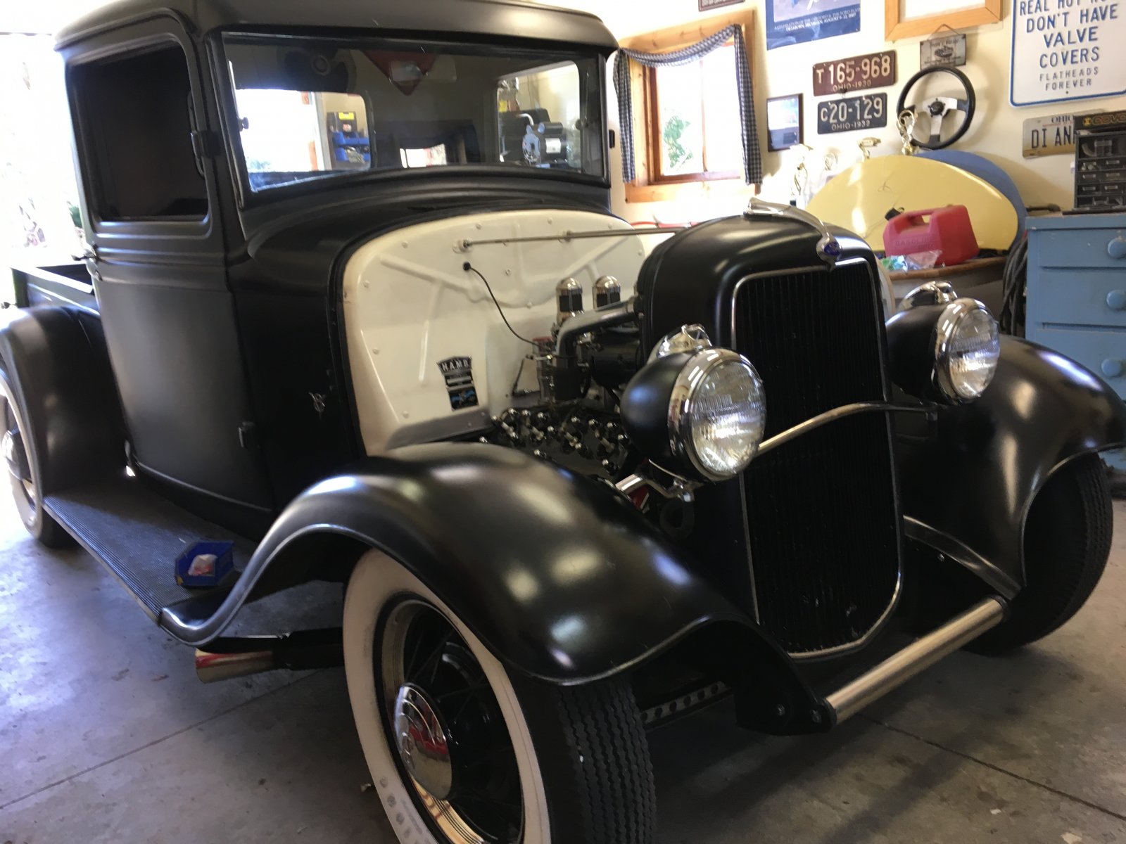

    Build picture 2.jpg To get room for the blower drive on my early hemi the motor went back 11 inches in my 34 tudor.... Every thing else in side the car moved back 11 inches... I still have lots of leg room in the car and the rear seat still has leg room....
