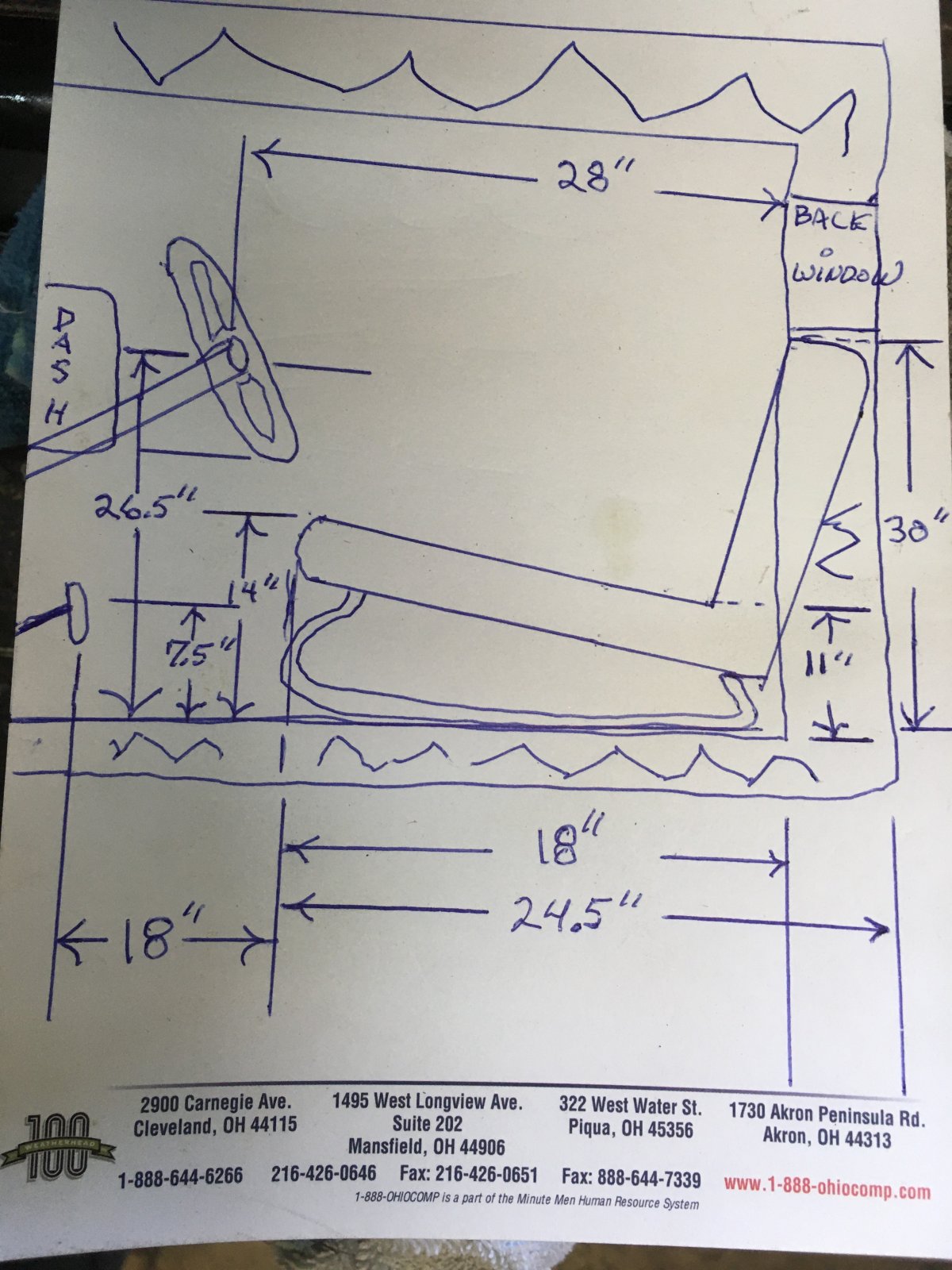

  3. 20220405_142423_resized.jpg 20220405_142332_resized.jpg 20220405_142501_resized.jpg Built a Model A during lunch with the measurements from @Petejoe. Envisioning getting under the steering wheel with peddles in my way. Channel with maybe the frame cut down and cab sitting lower on a 32 up frame which I believe is deeper than earlier years. A chop but, not both. At 5'11" and 175lbs I think I can do it although I would like to sit in one. Slid my chair back and forth to approximate forward and rear placement.
    Stogy and Petejoe like this.

    @Petejoe 's post was super informative and it inspired me to take some measurements of my chopped 30 A coupe.
    I tried to replicate his measurements (my drawing isn't nearly as good... haha) for comparison's sake.
    PSX_20220405_225512.jpg 20220405_223244.jpg 20220405_223241.jpg 20220405_223248.jpg
    My package tray is removed, which helps but the firewall being reversed negates that a bit. The car is chopped 4" but there are a few tricks to sneak a little extra room.
    I'm 6-2.5", long torso, 220ish. The car has been built to accommodate my size and comfort.

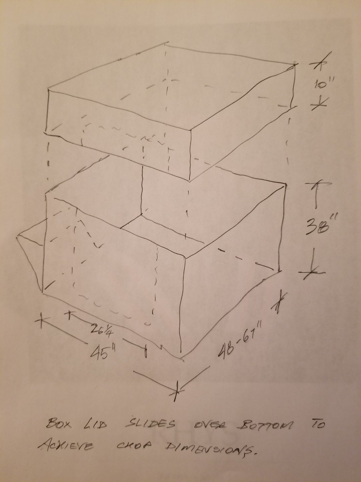

  17. Thanks @34Phil, This has given me an idea to make the plywood 'Chop Box' to add the dims from @Petejoe and @-Brent-.
    3 sheets of 1/2" ply held together with screws. Fire a seat and a steering wheel in there and play with dims until I get something to fit me. Top of the box is made slightly larger than the lower box. 3" chop , 6", 2" whatever, slide it up and down to size appropriately. I can make it the largest size to represent the coupe then strap the back to adjust for the truck and put a riser in the bottom to rep the channel. May even make an oval chop guide on the outside with predrilled holes and make it available to anyone who wants to sit in it. 20220406_205926_resized.jpg
    GasserTodd and Stogy like this.
