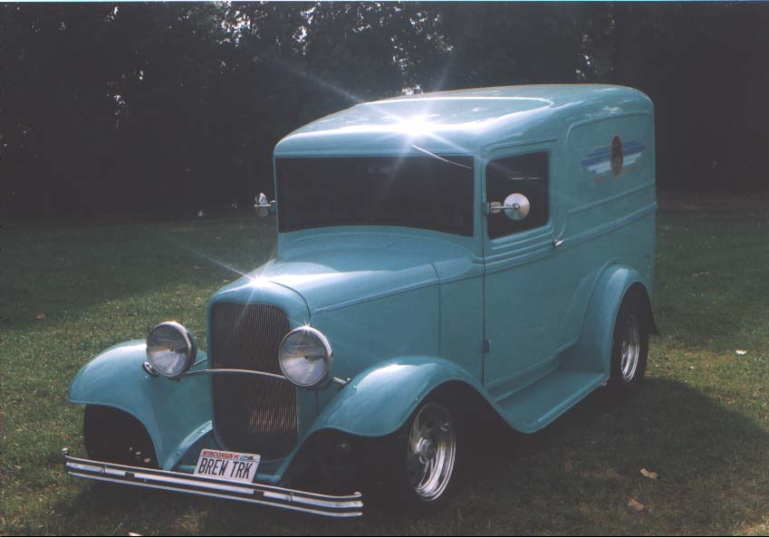

    Putting a chevy motor in a Ford is the same as transplanting a pigs heart in a human. Both my 32s have 302s in them. The panel has a AOD behind it and the coupe has a computer run AODE. Both combinations are fantastic. Good luck with your 40.
