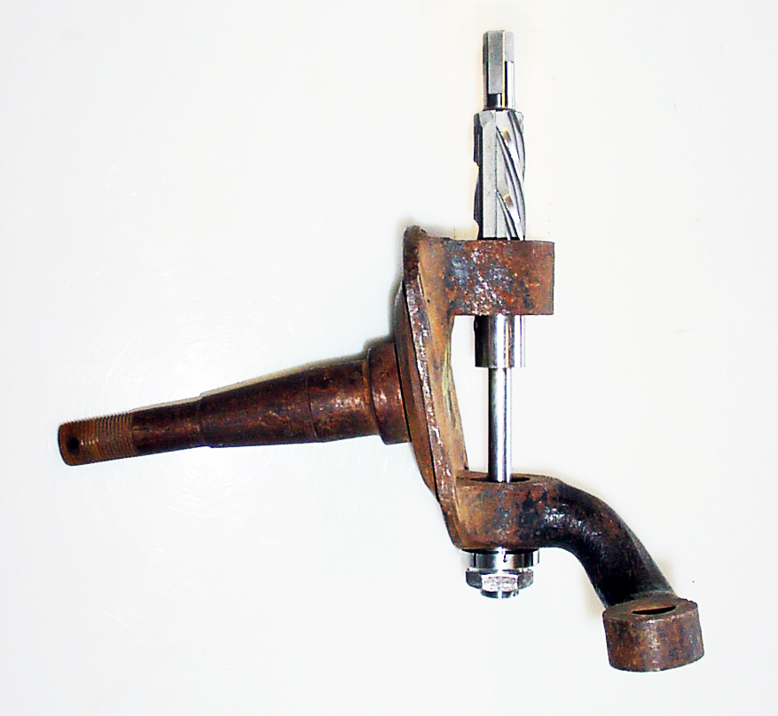

    Joined: Sep 1, 2008

  14. Here's a picture of a couple of styles of the piloted reamers that should be used for kingpin bushings. Do one bushing, flip it around and do the other. You can usually find both used and NOS reamers on the auction sight.

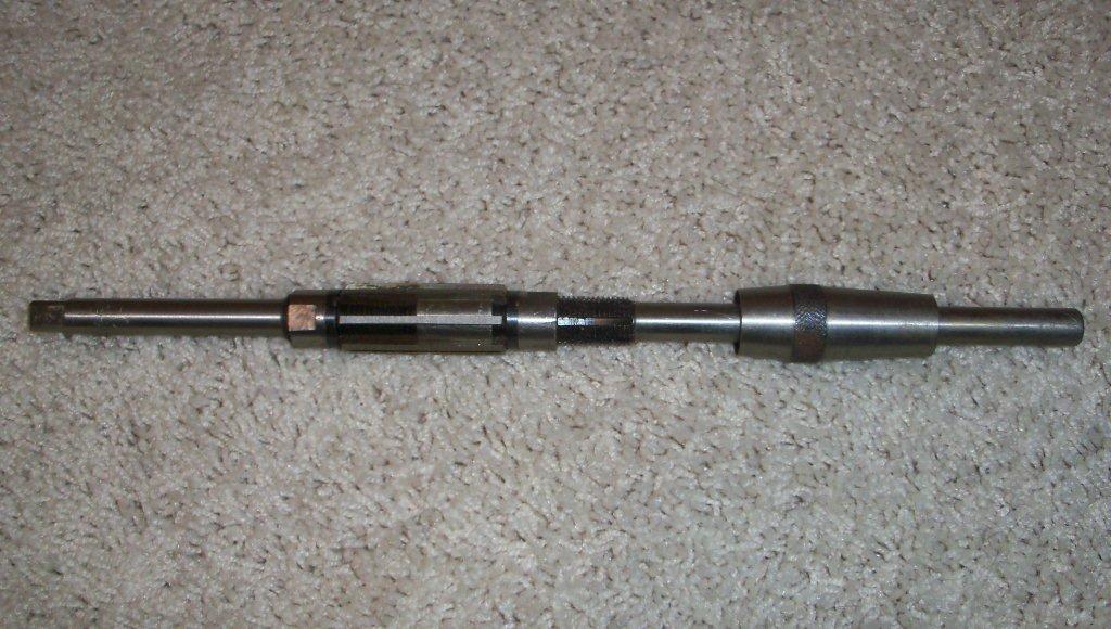

    I dont have access to a machine shop and will need to buy a reamer, having not done that before just want to check that this would be an appropiate way to go.
    stillrunners likes this.

    Pete, what you have is a line reamer and should work properly.
