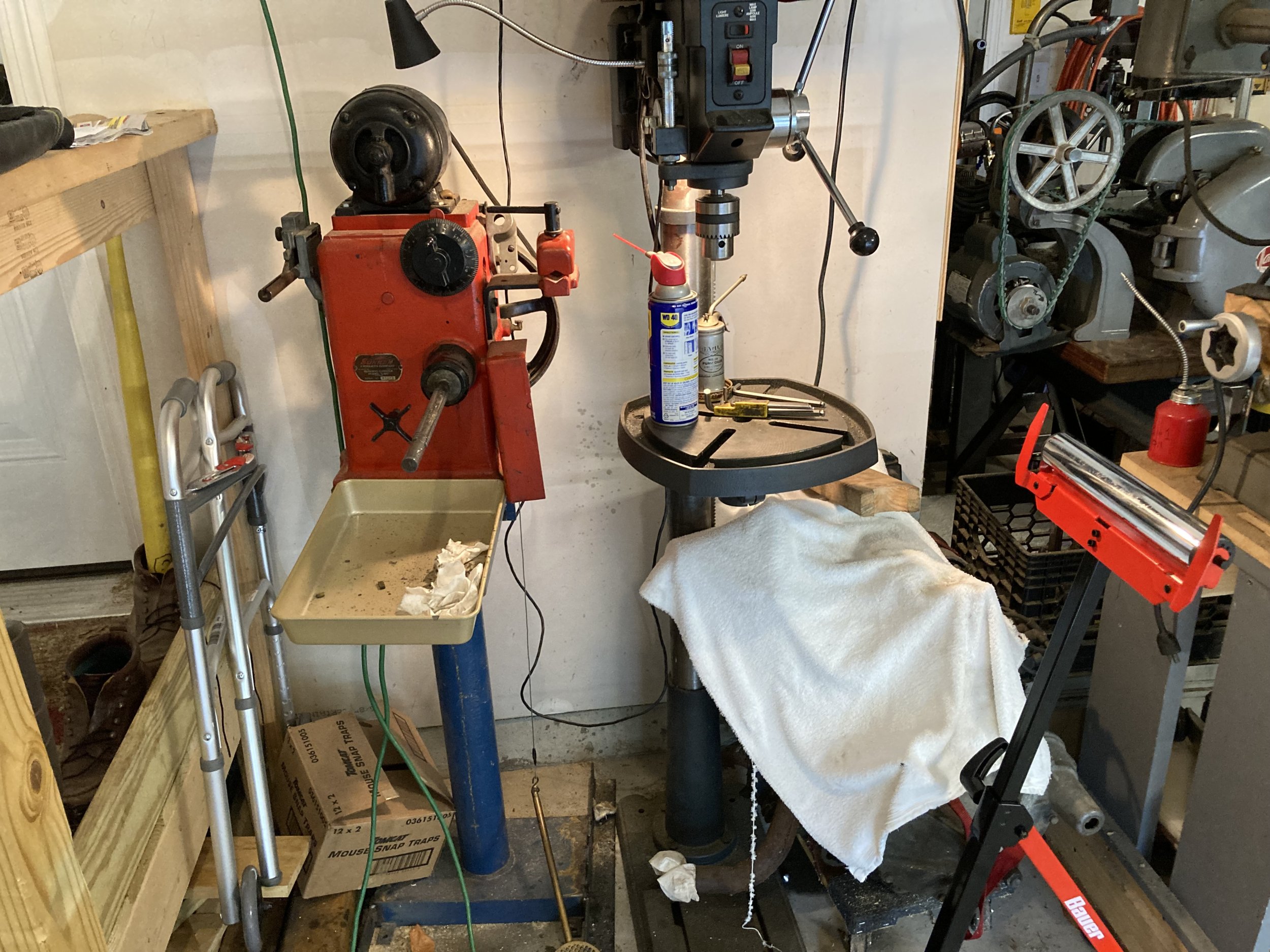

    What woodiewagon said. Local automotive machine shops will have a Sunnen bushing grinder and the correct mandrels for any size kingpins that you might ever install.
    The red machine is a 1928 Sunnen bushing grinder. I’ve been using it since 1975 when the original owner had retired and it was headed to the dump. It’s anyone’s guess how many sets of kingpin bushings this one has honed.

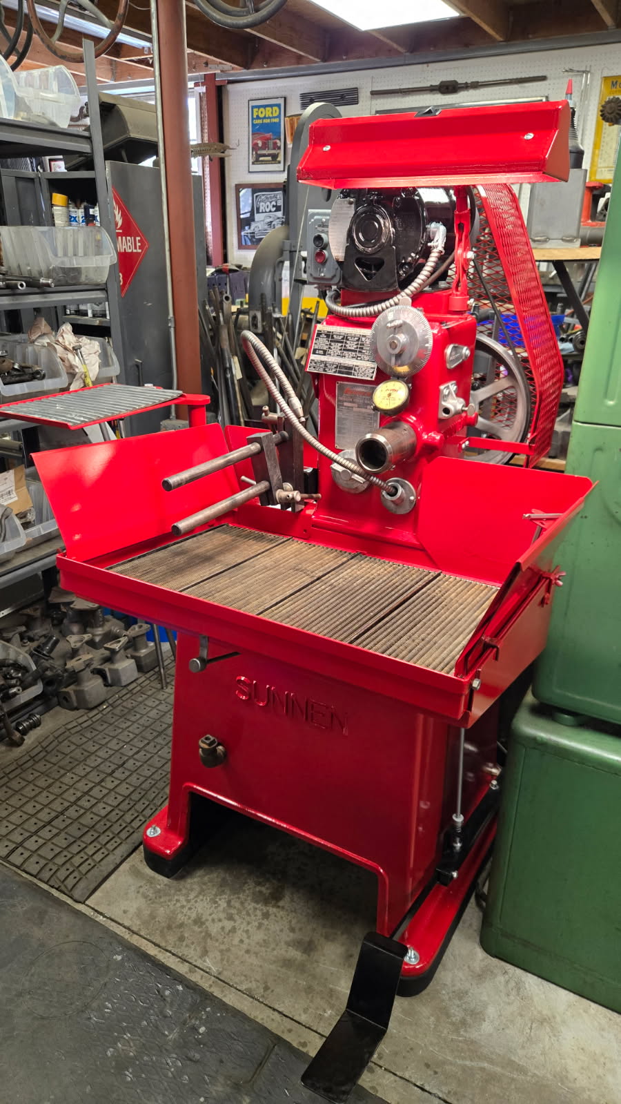

    Im a fan of honing king pin bushings. I recently upgraded to this Sunnen hone.
    Ive done probably 50 pairs of early Ford spindles for local friends and shops
    rod1, mgermca, linechaser32 and 8 others like this.
