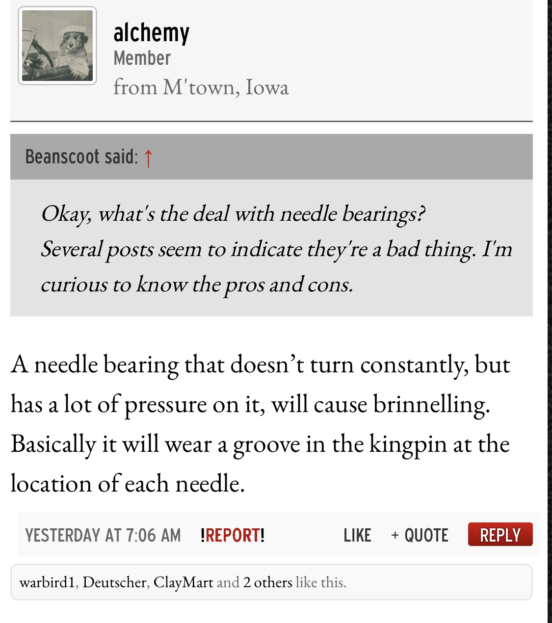

    A needle bearing that doesn’t turn constantly, but has a lot of pressure on it, will cause brinnelling. Basically it will wear a groove in the kingpin at the location of each needle.

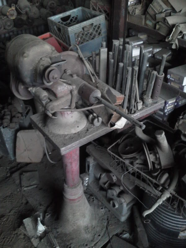

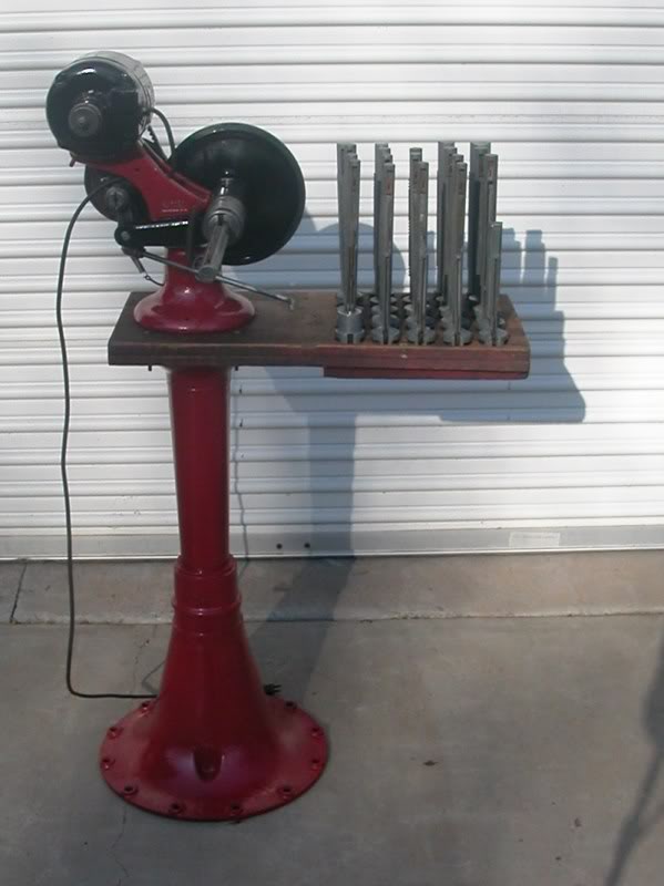

    It is great that Sunnen stayed with the same mandrel mounting design over the last 100 years, unlike most other technologies with planned obsolescence.
    My first Sunnen hone was from the 1920's I believe...
    fe11a84a-c4e8-49b8-a515-14fafa11d211.jpg 98e485a8-1075-45a1-95c4-39899185f23e.jpg c3529d7f-a266-4f77-aa15-0a2dce9b0995.jpg
    It was mounted to an old Fordson tractor axle bell. I did later add a coolant reservoir and pump.
    I then found this bench mounted unit at the LA Roadsters swap meet. I set it up on an old Craftsman saw stand
    It gave many years of service, but then was recently offered this unit for free.
    It was an industrial unit, so painted grey. It must have been sitting near something corrosive, as all the bare metal parts were very crusty.

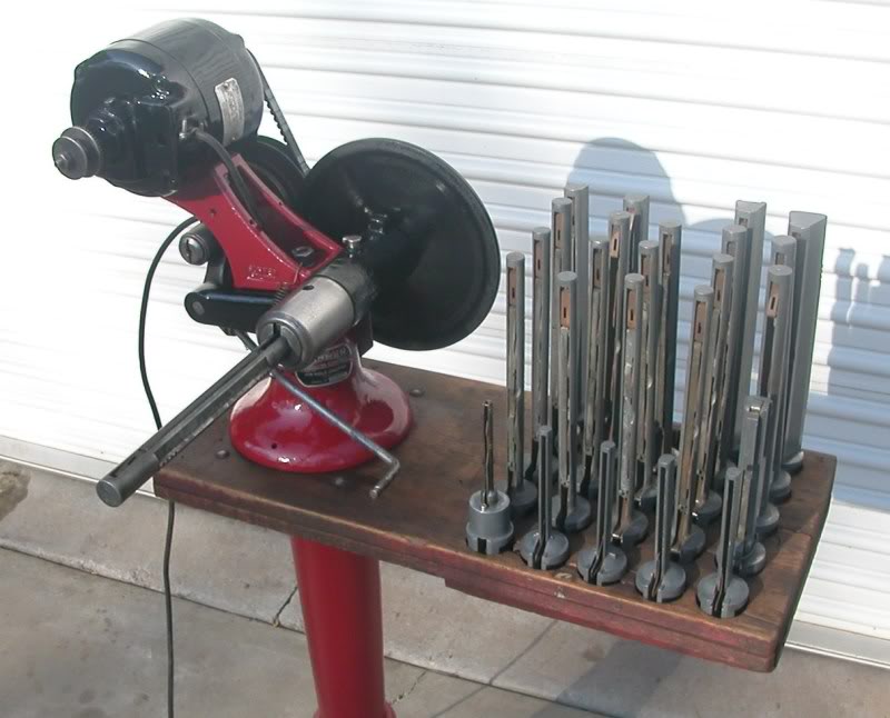

    I dis***embled it, cleaned and painted it red like an automotive machine.
    It has a few upgrades over the smaller machine. One being a bigger motor and then higher speed capacity. It also has a multistage coolant bin system, similar to a gold mining sluice box. This really helps to seperate out the bronze filings from the honing fluid.
