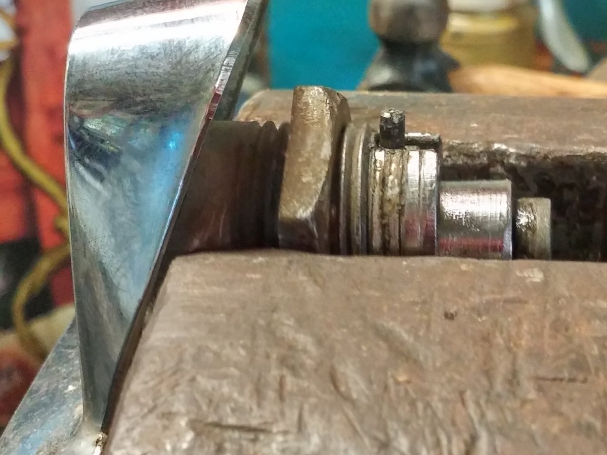

    As a side note does anyone know how to take the tumbler out of the trunk hardware?

    Here's what I did on the trunk lid lock on the '55 Ford I had. I'm guessing that the '54 is probably pretty close to the same? I took the entire lock ***embly/bezel out and held it in a vise. The pin you see that sticks up has to come out.
    Once that pin is out, take a pin punch or awl and tap the cylinder toward the outside of the bezel.
    View from the outside as the cylinder comes out of the housing -
    Here's the lock cylinder. If you want to do the "any key will work the lock" thing mentioned before, just pop the tin cover off, remove all the springs and tumblers and put it back together. The lock will still work fine, it's just that any Ford key will open it. But who's gonna know that unless you tell 'em?

  27. 325w
    Joined: Feb 18, 2008
    Posts: 6,527
    325w
    If you have a key for one like the 55 shown you can turn it and depress the pin shown. Otherwise drill it out.
