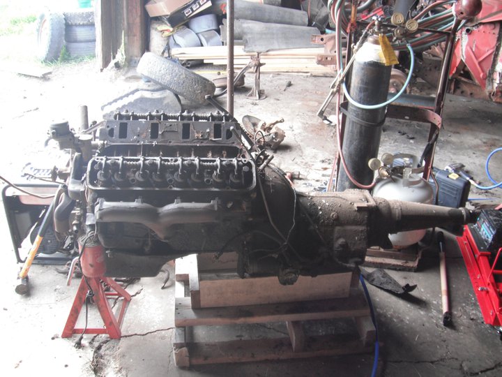

    Here's a pic that Lou Mack sent me of his '60 MEL with an adapted trans that he put in his '34 Ford pickup.
