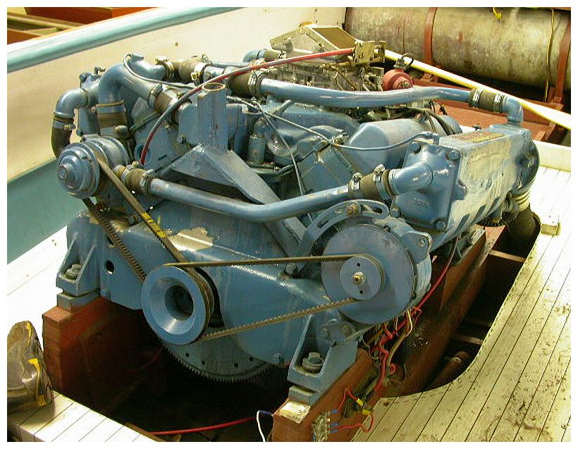

  6. mart3406
    Joined: May 31, 2009
    Posts: 3,055
    mart3406
    from Canada
    The MELs were also used as marine engines.
    Chris-Craft for one, and I think also Interceptor
    Marine and a few others also, used the 430 as
    the basis for numerous marine conversions.
    I'm not sure about others, but Chris-Craft
    called their marine version of the 430 MEL a
    "431" rather than a "430". Here's some pics
    of a "Chris-Craft 431", nee "430 Lincoln".
    Mart3406
    bedwards and Deuces like this.
