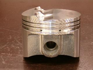

    Are the correct pistons available for theses or you gotta get them custom made?

    Pistons would have to be custom unless you could keep the standard bore and reuse them or found some old ones.

    Let me interject here. There is no direct piston copy for a MEL piston available unless as mentioned NOS. EGGE sells a piston that is correct for the 462. The engine design was changed so many times with piston designs that an exact repro would be difficult and costly to stock.
    DIAMOND RACING can either duplicate your piston or modify it about anyway you desire. WISECO also offers quality forgings and will work with you on an exact or modified copy.
    Most replacement 430 pistons are usually redone Buick blanks that do not duplicate the original dome design and lowers the CR dramatically.

    You know that would really help in the case of an MEL stroker, because once you bore it it's going to need a modified copy. Also may need the pin relocated to make a stroker setup work. I wonder if they could gas port it or would that cause any problems in the design of the combustion chamber? (i.e. ruin the swirl, etc.) By the way KULTULZ, and this is off topic, but how do you become an MEL registered mechanic?
