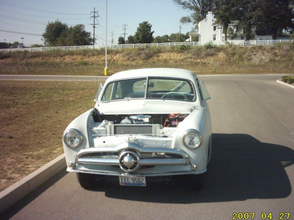

    from ohio
    I used the kit also did have to modify the sway bar clamps also used fatman spindles and steering arms .Both will give you about 41/2 inches without limiting arm movement and then used posie rear spings with 4" blocks on my old 50
