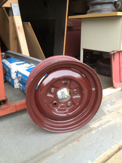

    Dido on that color choice. Here's mine, Kona Brown rustoleom, not the more readily available burgundy. I wanted that dark factory look but on the cheap and not black. I painted cars for years but get a kick out of using spray paint when I can. This wheel is just for mock up, still have to prep, smooth, and shoot four shiners. ImageUploadedByH.A.M.B.1404174553.091151.jpg
