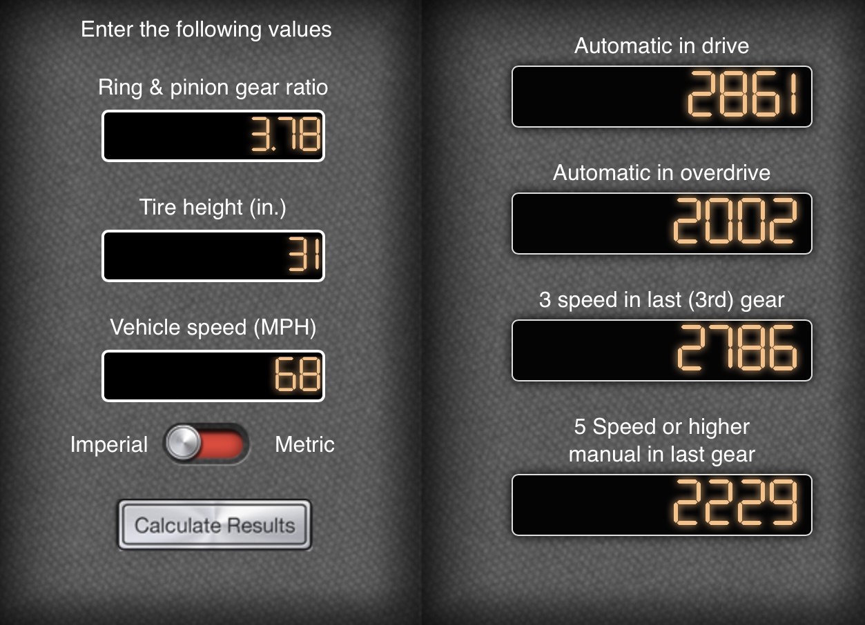

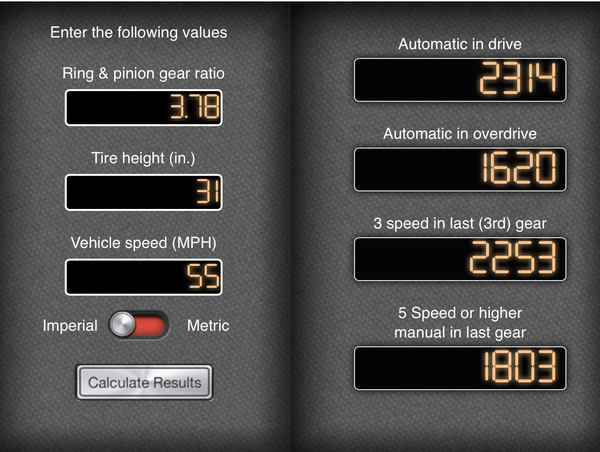

    I’ve used 16x750 rear tires on 2 As now and even though it only adds a couple mph, I think it’s worth it.
    Honestly, it’s as fast as I want to go with mech brakes.
    Also what OD % you use. I think there are a couple you can choose from
    Rpm calculator rough guess, no OD about 55mph- w/OD about 68. Guessing 2200rpm +/-

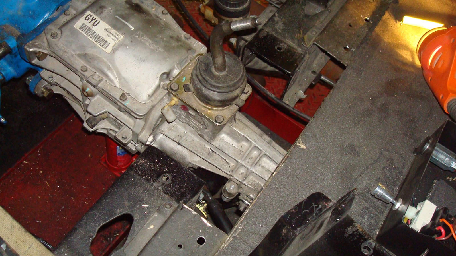

    This is what is in my Model A. Previous owner fitted it. It's a Ford pickup transmission.
    Even though I have it I don't drive mine at highway speed though. Going 85 in what is a relatively stock Model A doesn't interest me, in fact quite the opposite .

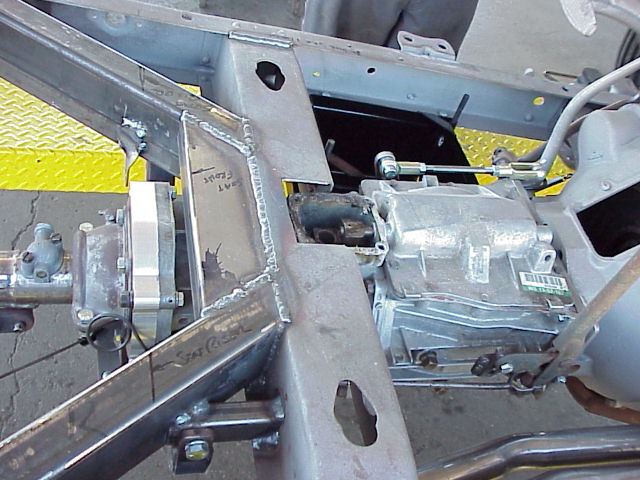

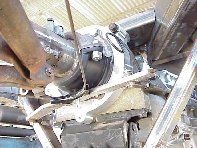

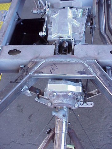

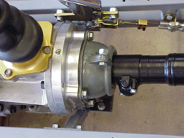

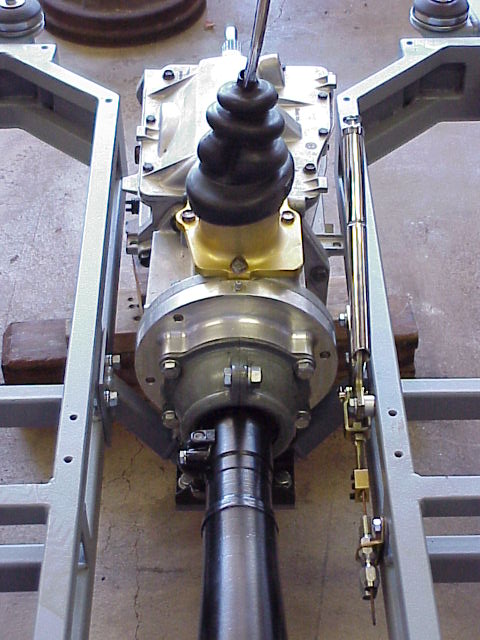

  29. Crazydaddyo
    Joined: Apr 6, 2008
    Posts: 3,372
    Crazydaddyo
    A T-5 with a torque tube can be done. It's not easy. I think it was well worth the effort.
    GuyW, randombob, drdave and 5 others like this.
  30. A Boner
    Joined: Dec 25, 2004
    Posts: 8,158
    A Boner
    So what are we looking at…how about an explanation or parts list. Thanks!
