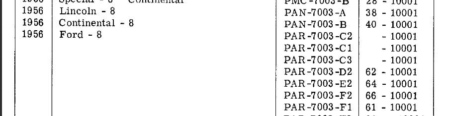

    A little bit of googling of the part number shows that it is indeed a 56 car V8 transmission.

    Where did you find this list?
