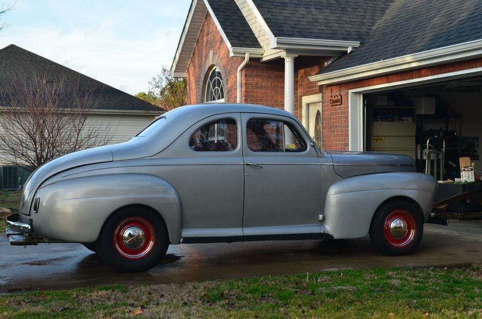

  27. Here are my 41 Ford deluxe Business Coupe with rear seat added and my 41 Mercury 8 that came with a back seat. My 40 5 window coupe has the closer body to the business coupe but the 41 was a wider body. The 41 Mercury had a longer front end.
