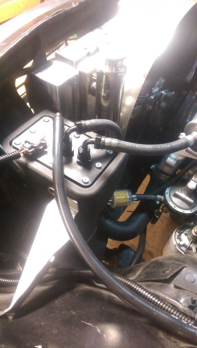

    OK so here's my update.
    I pulled my trans lines off radiator and fabed up brackets and installed a nice stacked plate 25 row trans cooler in front of radiator so it's an independent system now. And eliminated the pusher fan ( it was wired as a pusher)
    Pulled off shroud
    Tmr night I'm going to cut 3" off shroud to put it half in /out of fan blades
    install a new high flow water pump and top off coolant with "super coolant at***ive"
    Thursday my fan clutch and fan come in so they will go on as well as the FUEL INJECTION! Pretty excited about that.
    To answer a few questions I already have the matching shroud for the radiator it was for the ele fan. I modified it to work with the bigger upper shroud. it alone was meant for ele fan only and wasn't close to working mechanical fan.

    Update.
    New high flow waterpump installed
    New 25 row stacked plate trans cooler installed
    New fan and clutch installed
    Cut shroud
    Had to get edelbrock efi sump kit because fitechs was back ordered till Sept. But that and fitech are both installed and I had it running.
    I did the paper check and it's pulling enough air to hold a piece of paper on both radiator and trans cooler at idle
    When I cut the shroud I cut 3" off and stopped the fan is still not half in/half out though. I would have to cut another 1" off and by that time the shroud would only be an inch wide I think defeating the purpose of a shroud??
    I'll post new pictures in a little bit. Also I'll take new measurements of fan spacing from radiator.
    I have a few wiring issues to tidy up with efi.

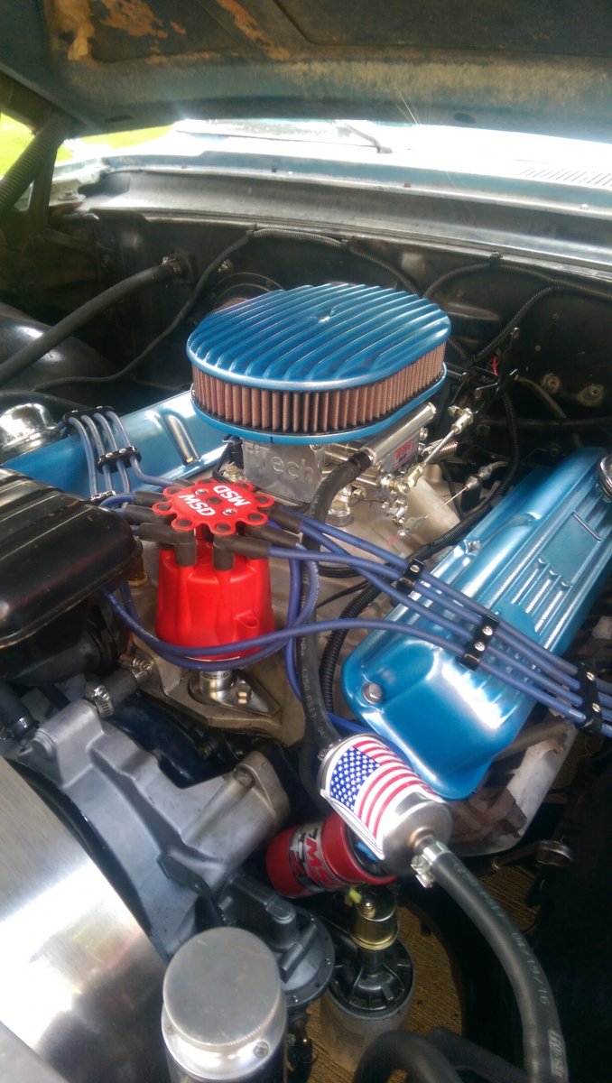

    Update.
    I took it for it's first drive and it gets to temp fine and stays around 190 while driving just like before.
    If you let it sit it will still creep up and yesterday I let it sit for a few mins and it went right to 205 and I just got impatient and shut it down knowing what the outcome would be.
    And she definitely still runs hot. You can feel the hood , fenders everything up front is screaming by they time it says 200degs.
    The fi system came with electric coolant temp sensor so I'm very confident that it's accurate and it's reading close to what it was with cheap sunpro gauge
    I'm not sure if cutting the shroud helped or hurt. To me it doesn't feel like its pulling as much air now but it still holds paper to radiator at idle.
    I reset timing at 12 degs initial at 2000rpm with vacuum plugged off. And when I plugged in vacuum to me it seem that something wasn't 100% right. Still was at 12 degs at idle but the advance was slow to come on and wasn't working right (cheap China hei)
    WHATS NEXT.
    I ****ed it up and ordered a Msd Pro billet distribtuor, Msd blaster 2 coil and holder.
    I plan to lock out the distributor 100% and control all timing off my handheld controller. That way I can set timing at idle and when and where I want the timing all through the rpm range.
    Also looking into a becool / Griffin radiators to see if there any different than my champion.
    Looking into making or having a fab shop make a complete 100% shroud

    Ok. So to put an end to all the timing issues I ****ed it up and switched to Msd Pro billet and blaster 2 coil.
    Now I know exactly what timing is at all times. Initial is at 10deg ,idle is also at 10degs and 36 all in.
    Initial is only used for crank then once fired it gos to idle timing.
    And with all the changes made it does run about 10degs cooler while cruising 180ish now
    BUT it still gets hot while sitting. I haven't let it go past 210 not because that's to hot but because I know it won't stop climbing.
    It won't vapor lock anymore but if it's at 205 or 210 when I shut it down it will boil out. IMAG2001.jpg

    The msd distributor helped quite a bit.
    Still gets hot when it sits in traffic or lines at car shows and it's super hot and humid out. I just drove the **** out of it and stopped worrying. The vapor locking subsided as long as it wasn't 210 degs.
    I'm running a fan clutch now and my half *** shroud.
    I'm still planning on making a nice custom shroud for it this winter. But I pretty confident that it all stems back to having thin cylinder walls.
