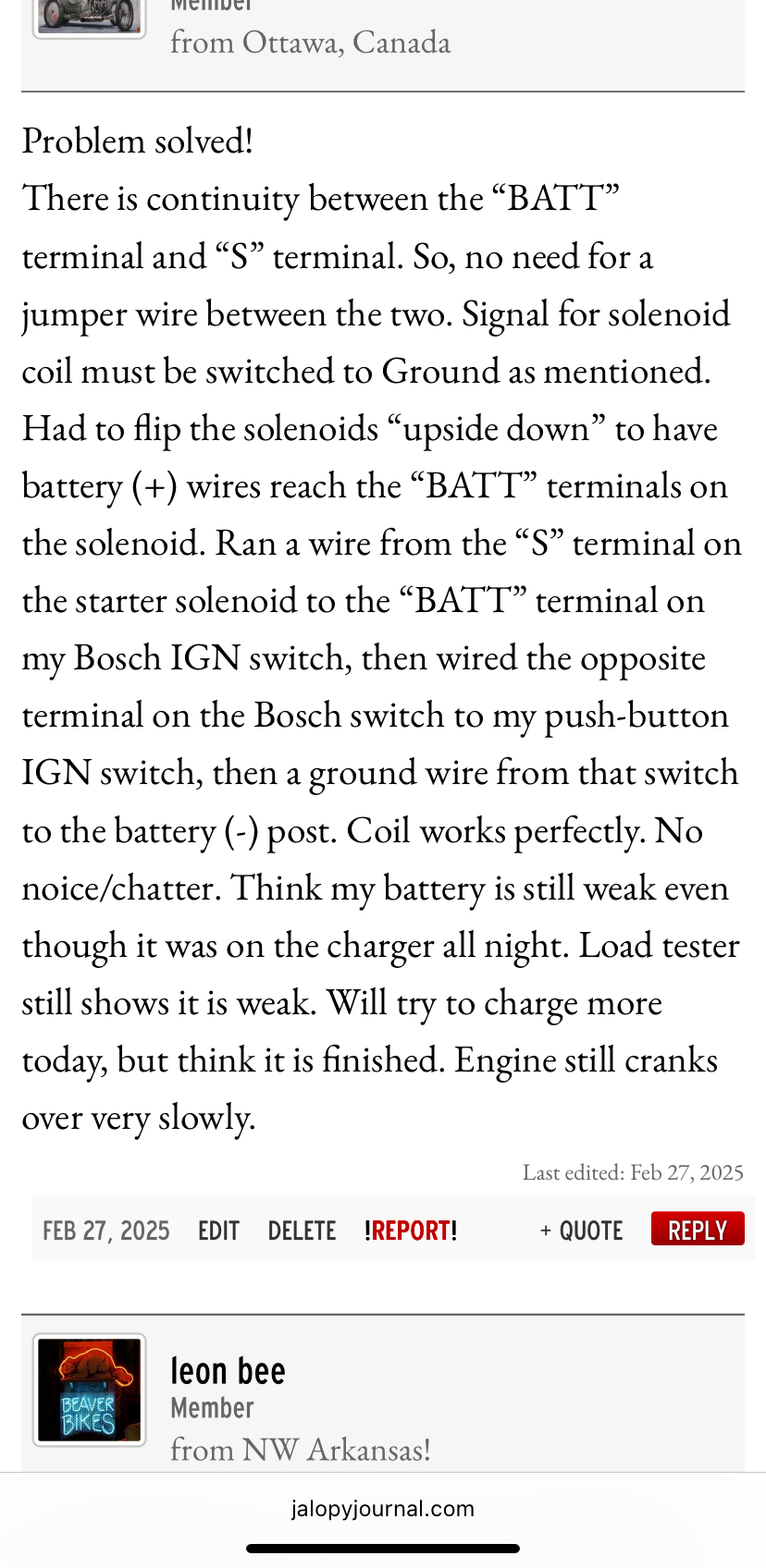

  23. Ziggster
    Joined: Aug 27, 2018
    Posts: 3,565
    Ziggster
    I have the same solenoid and had to run a jumper wire to make the ign work after wiring it all up. Wish I was at home so I could explain what I did.
