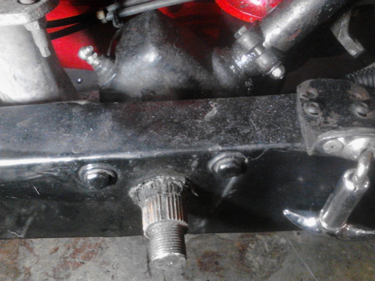

    this box was in my in my roadster I believe it was a 42-47 bigger truck box. it had a welded pitman arm on it never broke just didn't trust it. when I replaced it I found the sector shaft & steering shaft was bigger than standard car or light truck .it drove & steered well [​IMG]

    a 68-72 A body speedway #910-32560 pitman arm fit. had to file master splines to position, ream tie rod hole heat and bend to clear wish bone [​IMG]
