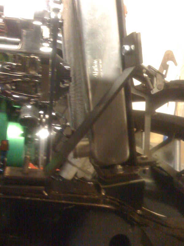

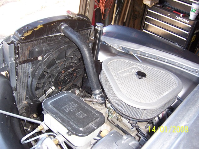

    I am using the same fan in my 54. Here are a couple of pics of it installed early in the build. I have since modified the mounts to take all the weight of the fan off the radiator core.
    The shroud of this fan can be cut down to provide additional clearance. I think I trimmed 2 inches off mine.
    I had wired it to have the high speed kick in with the AC compressor but it proved to be too much of a draw for the relay on the Derale fan controller. It works fine with the low speed though and I have an override switch to activate the high speed should it be needed.
    So far it keeps the temps about 180 in Houston traffic with the AC blowing.

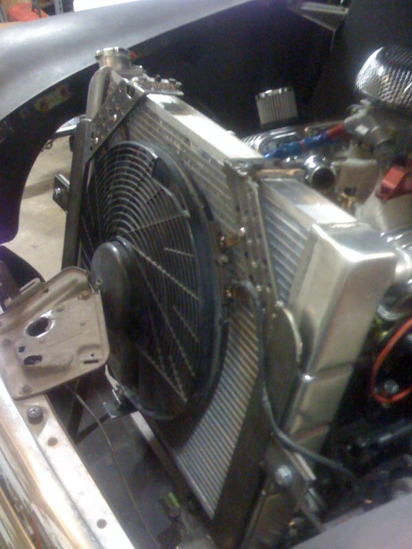

    I snagged a Mercedes fan (at Pick n pull) and man it is powerful. compact and look better then most. You can see in the last picture WHY I went electric and made it a Pusher.

    How could this be made into a pusher?
  21. tfeverfred
    Joined: Nov 11, 2006
    Posts: 15,788
    tfeverfred
    Mount it in front of the radiator.
  22. terryr
    Joined: Feb 8, 2007
    Posts: 285
    terryr
    from earth
    The fan blades can't be flipped. The plastic fits onto the shaft one way.

    d) You'd need to mount it with the bracket opposite the radiator; the fan won't be very efficient spinning backward.
    For a puller, the Taurus fan's a good one, the Lincoln Mark 8 fan is even beefier if you've got room.
    Many factory pushers were auxiliary fans on Euro cars with engine-driven fans. Can't think of too many that use a pusher as a primary fan.

    As JEM said in the post above the fan would have to be mounted so it pushed the air through the radiator into the engine compartment. Not a hard thing to do but it won't **** up to the radiator like it does on the back side.
