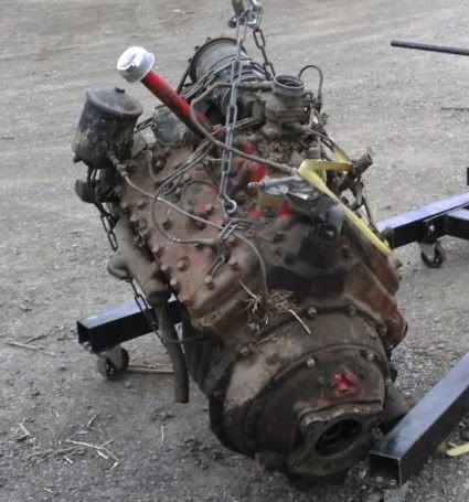

    This is my 8-BA with a ford truck bellhousing and hogshead with an adapter that was used to hook what the seller called a "Ford 4 speed" to the hogshead. Basically an early top loader with a Jeep shifter on it.

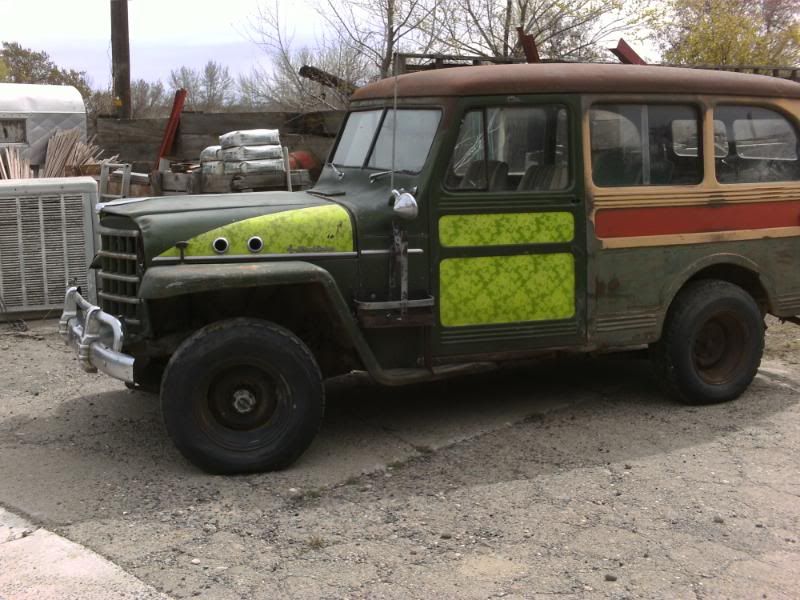

    That flathead came out of this "huntin rig"
