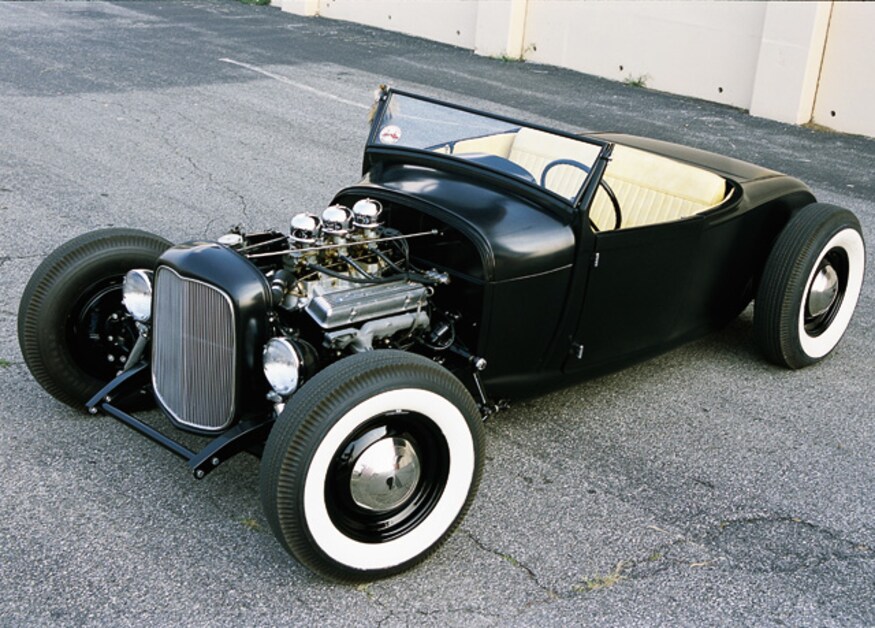

    OK, here's a teaser.
    Tim, Petejoe, kadillackid and 4 others like this.

  17. Moriarity
    Joined: Apr 11, 2001
    Posts: 37,504
    Moriarity
    SUPER MODERATOR
    really cool... why have you been hiding this from us????
