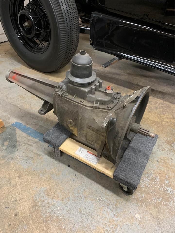

    Has anyone used a ford 3sp overdrive transmission behind a flathead they was from the 80 ford truck from what i gather[​IMG]

    I had one in a 79 F150, 2:75 rear. Geared way too high. I would use at least a 3:73 rear. Made
    in Mexico. Came apart with low miles. I would look for T-5.

    The trans you have pictured is a TREMEC T170 RTS that came in 84-87 F150’s. It’s a different transmission than what was in the 79 pickup. Quite a few folks have used the T170 behind flatheads. Do a search. Also there are some threads over on The Ford Barn about that setup. I’m putting one behind my Flathead in my 39.

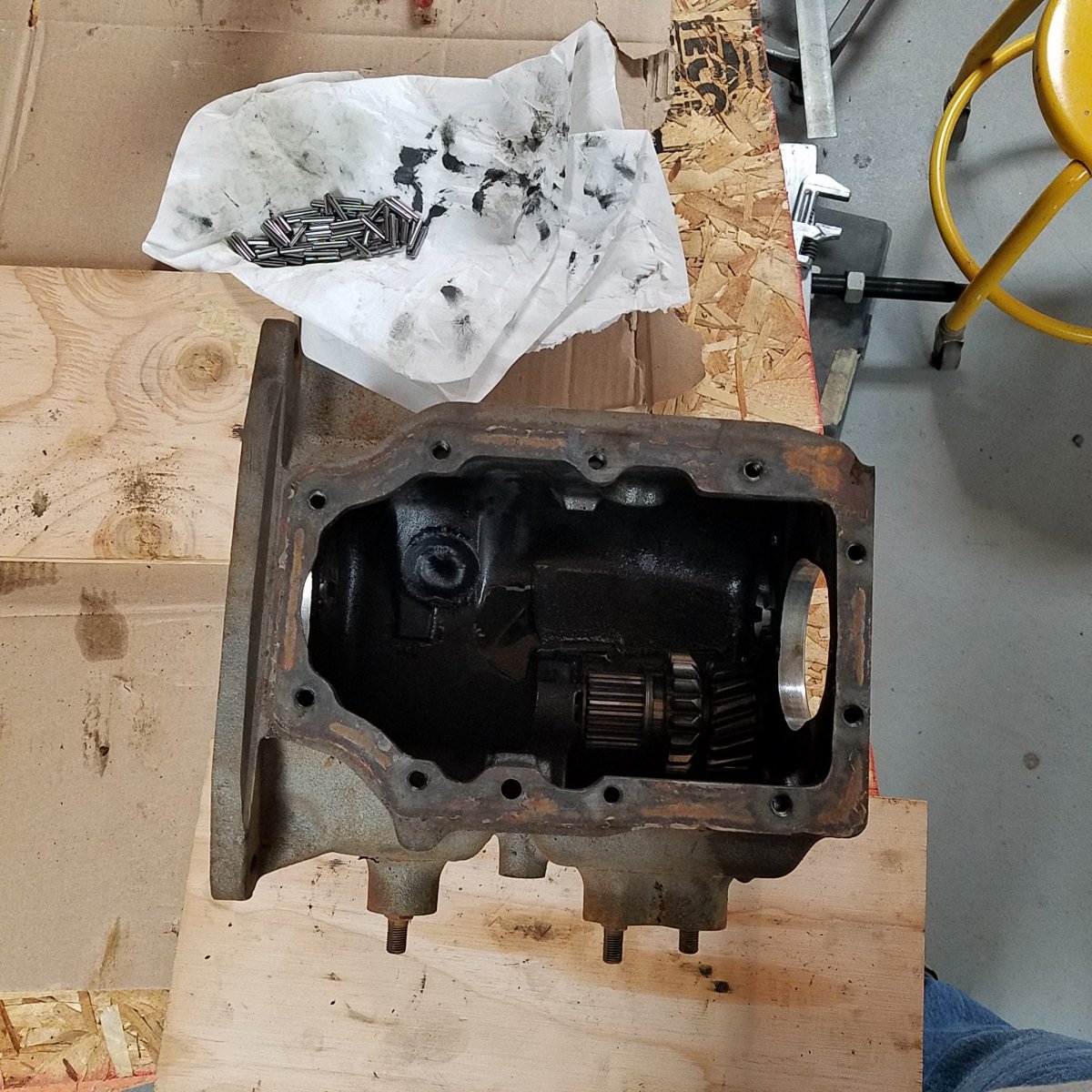

    I have one apart right now.
    This is an iron case side mount overdrive (smod). 20210207_163310.jpg 20210207_163303.jpg
    What you have is the same internals but is called a "top mount overdrive" or TOD

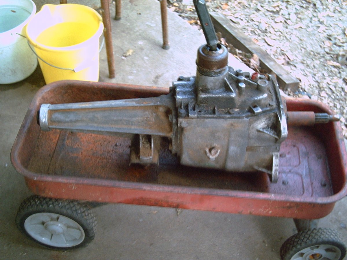

    Yep - they made a cast iron OD first based on the Ford top loader 4 speed - can't believe a built flat head could tear on up.....then came the aluminum TOD - still strong enough for a banger or flathead. ford overdrive top loader.JPG ford tod 4 overdrive.JPG ford overdrive top loader.JPG ford tod 4 overdrive.JPG
