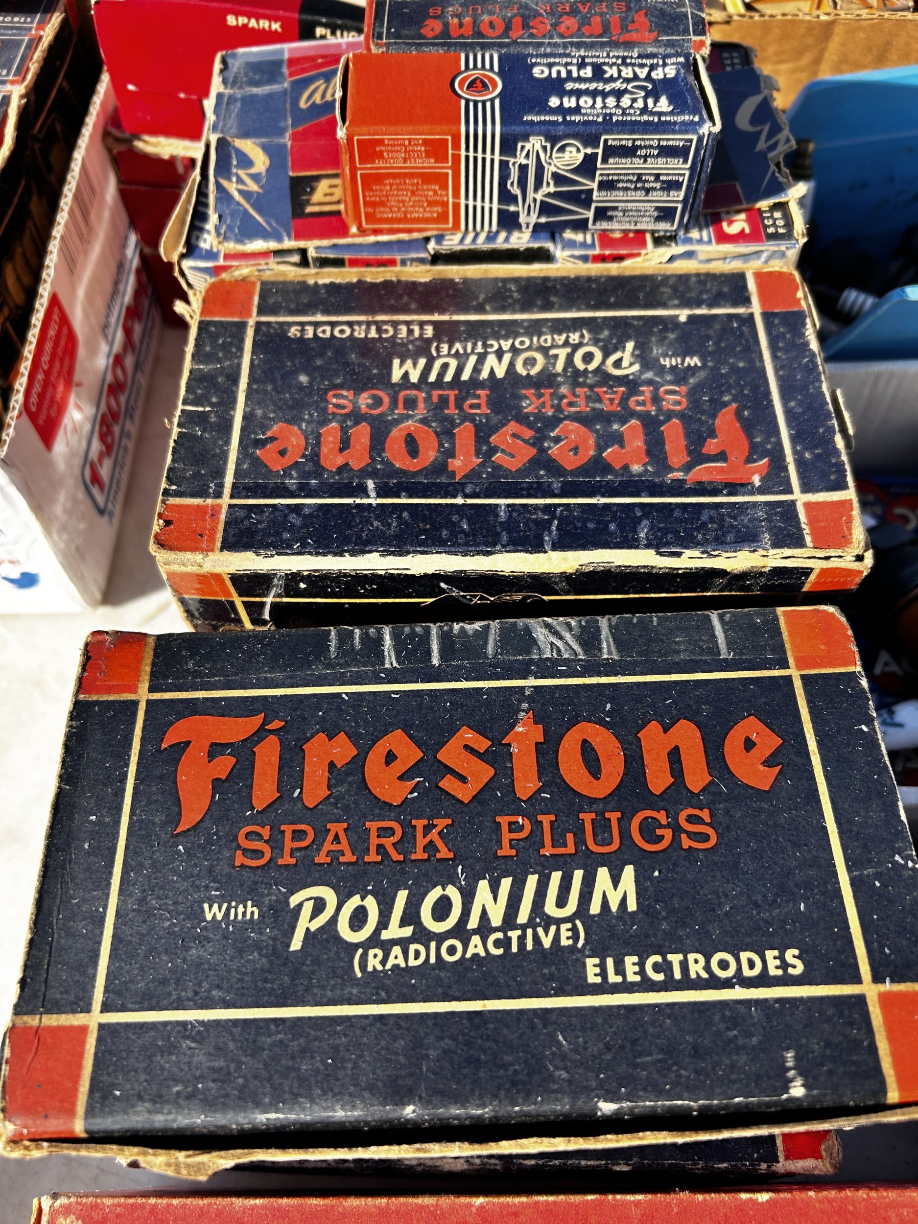

    Maybe these are a good choice:
    Just kidding:oops: Saw these at Hershey last fall.
    I’ve run Champions, Autolites and believe it or not, I have a set of ACs that came on a really smooth 8BA that I don’t plan on changing anytime soon.
