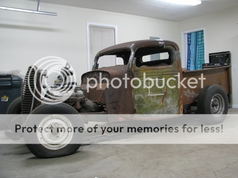

    Is here anyone who would be willing to do a photoshop job for me???
    I got this nice shot of the truck:
    Well now I'd like to have it lowered 4" on the front axle and 2" on the back.

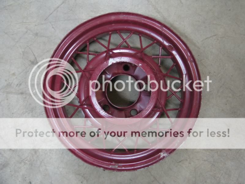

    I'd also like to have this wheels and wide whites on them:
    Would also be cool, if you could move the grill a little lower and dress the engine up :D
    That would be very cool, thank you!!!!

  13. Here you go Martin. I couldn't find a good Olds motor, but I figured a hemi would work. Also, I think the wheels look better black. BTW, that's Dreadman's cowl steering.
    Before:
    After:

  15. Dave, this one looks awesome!!!
    The hemi works fine, and also the cowl steering :D
    do you think, the black wheels also work with a flat black paint job??
    I was thinking about the same red for the wheels as the red for the motorblock!! What do you think??
  16. I should have mentioned the paint job...
    But I didn't think about it, in that moment!!
    I hope the green is gone very soon :D

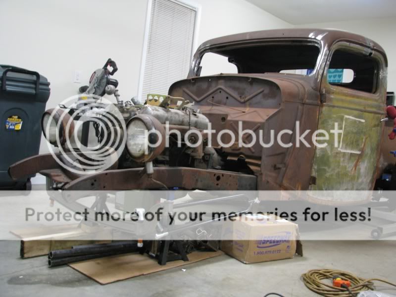

    Today I got a nice package from Speedway Motors.
    Front suspension parts, that's what I was waiting for!!!
    So I mocked up my new front suspension, as far as possble:
    Still need some parts, but hey: STEP BY STEP!!! :D
    Brake Parts and wheels are out for powder coating now, will also give the axle out for coating.
    So I have just time to do the engine swap.
    Got me these new motor mounts on ebay:
    So I just have to weld me the other part to the frame!!
    Hope to get them this week!!

    Glad the hood fit so well.
    It looks like that frame was already boxed.
    I had to rethink my front suspension. Look like spring over axle set up like yours.
    I did manage to find my Y -block and 3 x 2 intake.
