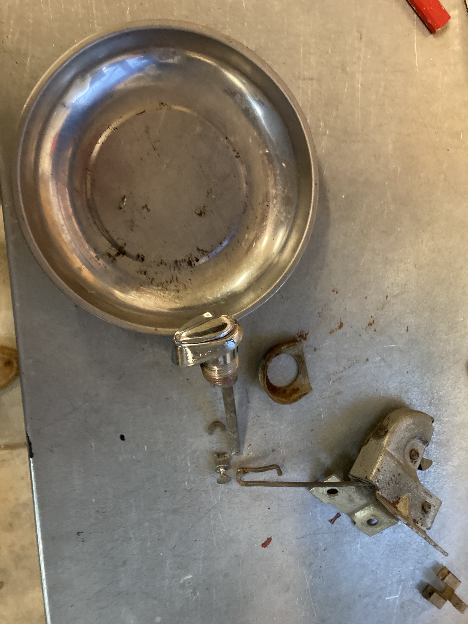

    I inserted key into the trunk lock on my 58 Ford Fairlane and the key and lock spin in a circle and will not unlock. Will spin just as easily clockwise or counter-clockwise.
    I have never had a problem with the trunk latch and the SOB worked fine literally 5 minutes before!
    Any thoughts would be greatly apprciated1

    something broke or fell off. take out back seat to get a look at backside of lock and go from there

    Will the tumbler come out with the key?
  4. mammyjammer
    Joined: May 23, 2009
    Posts: 561
    mammyjammer
    from Area 51
    Tumbler stays in the latch.

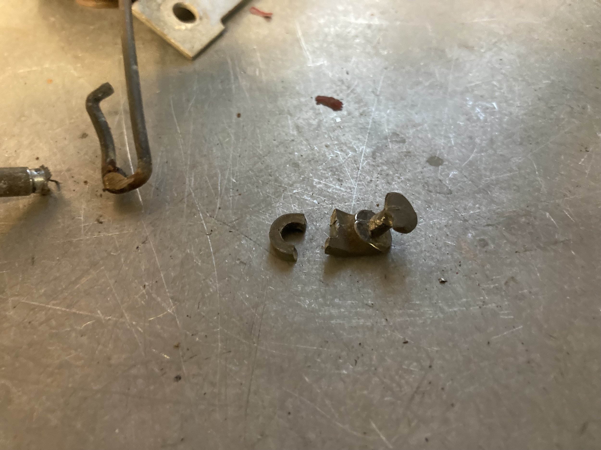

    I was hoping the problem was in the lock, but the pot metal arm off the lock shaft is broke.
    I will see if I can find one, or fab something up.
    Thanks.

    Damn mazak metal. Copy it in brass.

    I got to check out a 56 Fairlane and 57 T-Bird at show and they appear close enough to work.
    Now to find one or the “ copy it in brass” suggestion sounds like a viable option!
