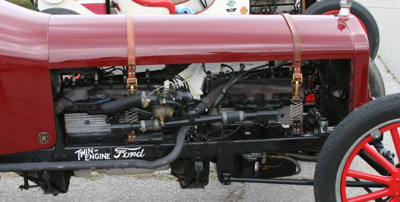

    Not long after I bought the fairground racer that has grown into “The Gin Runner” my ’26 Gowjob T i found a picture here on the HAMB of the late Gary Le Fever’s twin engined model T. I was totally smitten by it, I have always wanted a vintage straight eight race style car but know that I could never afford to buy one…. so I tracked down a phone number and called him at his home in Wichita and we spoke for a while about his car and how he put it together.
    I started to hatch a plan to build a TwinT using a matched pair of ’26T motors chain wrapped together and set up to run as a straight eight. The standard Ford “bent coat hanger” cranks have been a concern since day one, but I reckon if I can build the motors individually with good balance and use a floating transmission shaft as well as the chain wobble joint, it should be able to work together without tearing itself apart.

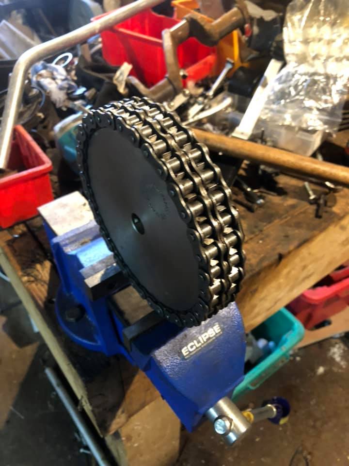

    I started to put the two motors together just before Christmas and so far I have made up the chain joint using two chainwheels the front drilled to suit the rear crank flange of the front engine’s crank and bolted to it using countersunk set screws, the rear drilled to suit the nose of the rear engine’s crank which is pinned through the starter dog’s bolt hole. I will also be cutting a keyway and fitting a woodruff key.
    The next stage is to make up the “girdle” so the motors can be held in line.
