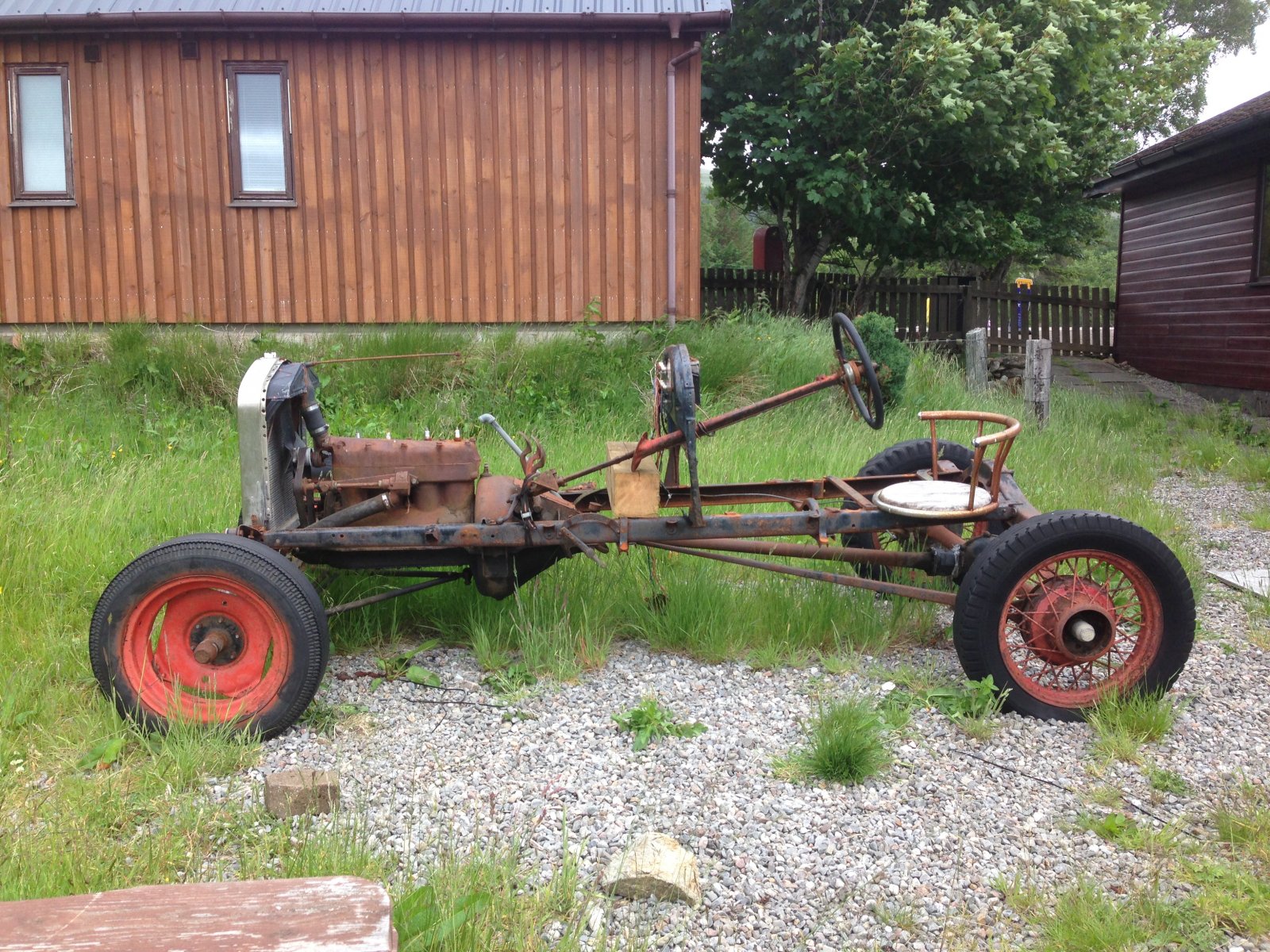

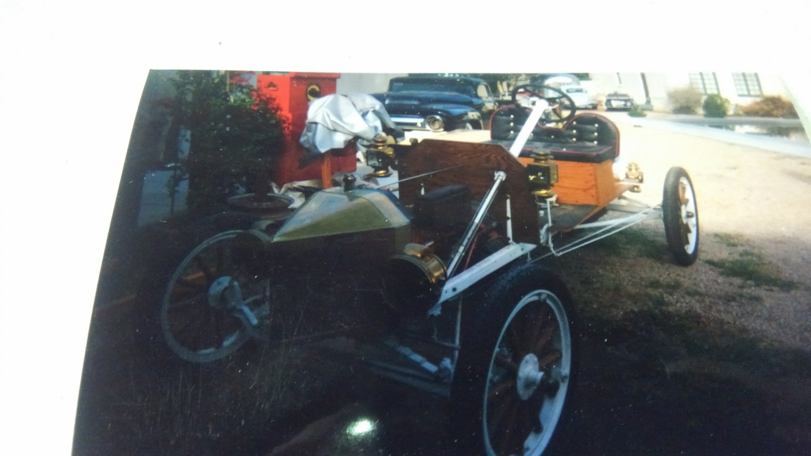

    finally got some barn time and cleared a bench for the TwinT project, loosely set up to see where I got to and an old pic of the T ch***is with space for two motors IMG_3534.jpeg IMG_3531.jpeg 254518762_4940887022622556_5338701135788294378_n.jpg 247992651_4940887005955891_3161137978363767318_n.jpg

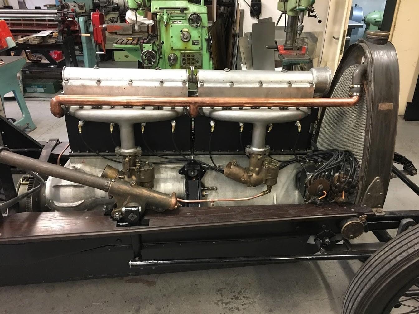

    I believe I have a picture of the one I saw when I was working with a character in Phoenix... I will look for it when I get to the shop...

    Have you ever seen a Durant Speedster? 1924ish ? He used a pair of Continentals (I think) 4cyl with a common crank, very similar to what you're building.

    No, I haven't I'll do a bit of google searching.. I know of a a Bugatti 8 that was done that way on an ally crank case

    KIMG9696.JPG actually.... It's Six, never mind...

    There were a few pre T race cars along with the production Model K that were 6 cylinder engines, all jug type that I know of. Ford also made a few experimental T 6 cylinder engines that were used in Edsel Fords speedster and possibly other test cars as well. These would have had very similar T design characteristics.
    The T 6 cylinder picture above was a relatively well known modification of stock components similar to this dual engine 8. There was even a T dealer back in the day that produced a V8 made up from modified T engine parts!

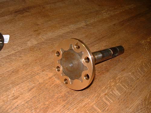

    I have a length of tube of the correct diameter for lining up the blocks that I will use once I have got the exact distance between the crank ends fixed. I plan to use one of Les Schuberts flexible trans shafts to try and help keep the balance issues to a minimum

    Are those shafts easy to obtain? I have had only tiny success making one myself.
  26. Blackbob
    Joined: Nov 19, 2008
    Posts: 191
    Blackbob
    I haven't tried to buy one yet, the seller is active on the MTFCA, that being said, I have a mill and a lathe and two spare trans shafts ;)

    You'll only need one shaft. And a 12mm steel plate i believe. Could be 10mm. Been a while since i fitted it to the engine.

    Yeah, from memory Les reduced the flange on the shaft by 0.005" and made the outer plate in 660 bronze to the original depth.
