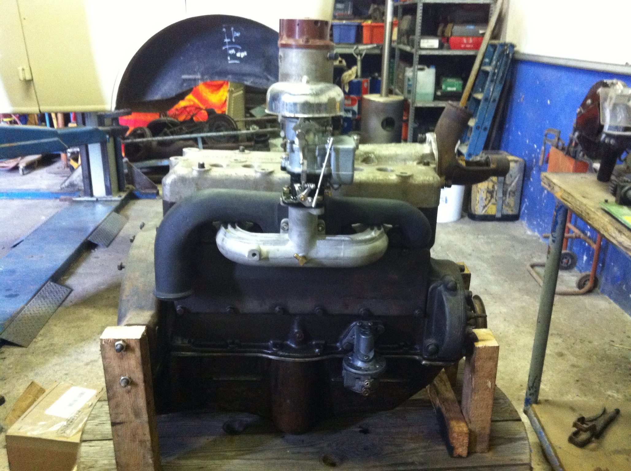

    What do you think about this, i would like to run it, in a 30's looks model A racer.
    NOS high compression aluminum head, NOS BURNS intake, new stromberg 97's,
    i found a 81's stromberg, and seems to be better for this motor,
    NOS VERTEX magneto, cal custom air filter....

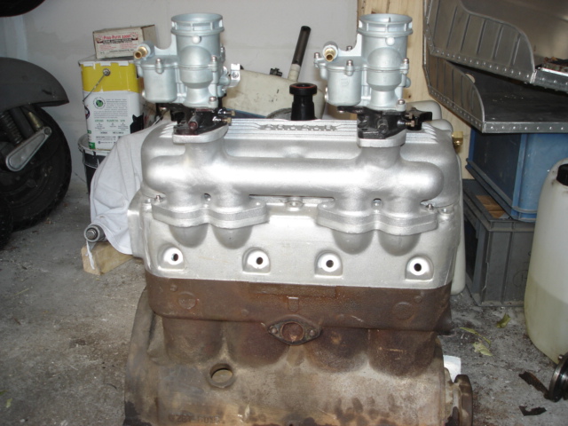

    what sort of head is this??

    repro Cragar OHV ...
  6. Starter or push start ? If you're going to use a starter, you'll be happier with a Mallory dual point distributor. Unless you're doing extensive internal mods, no more than a 3/4 race cam with adjustable lifters. Have steel valve seats installed, and use stainless steel valves.

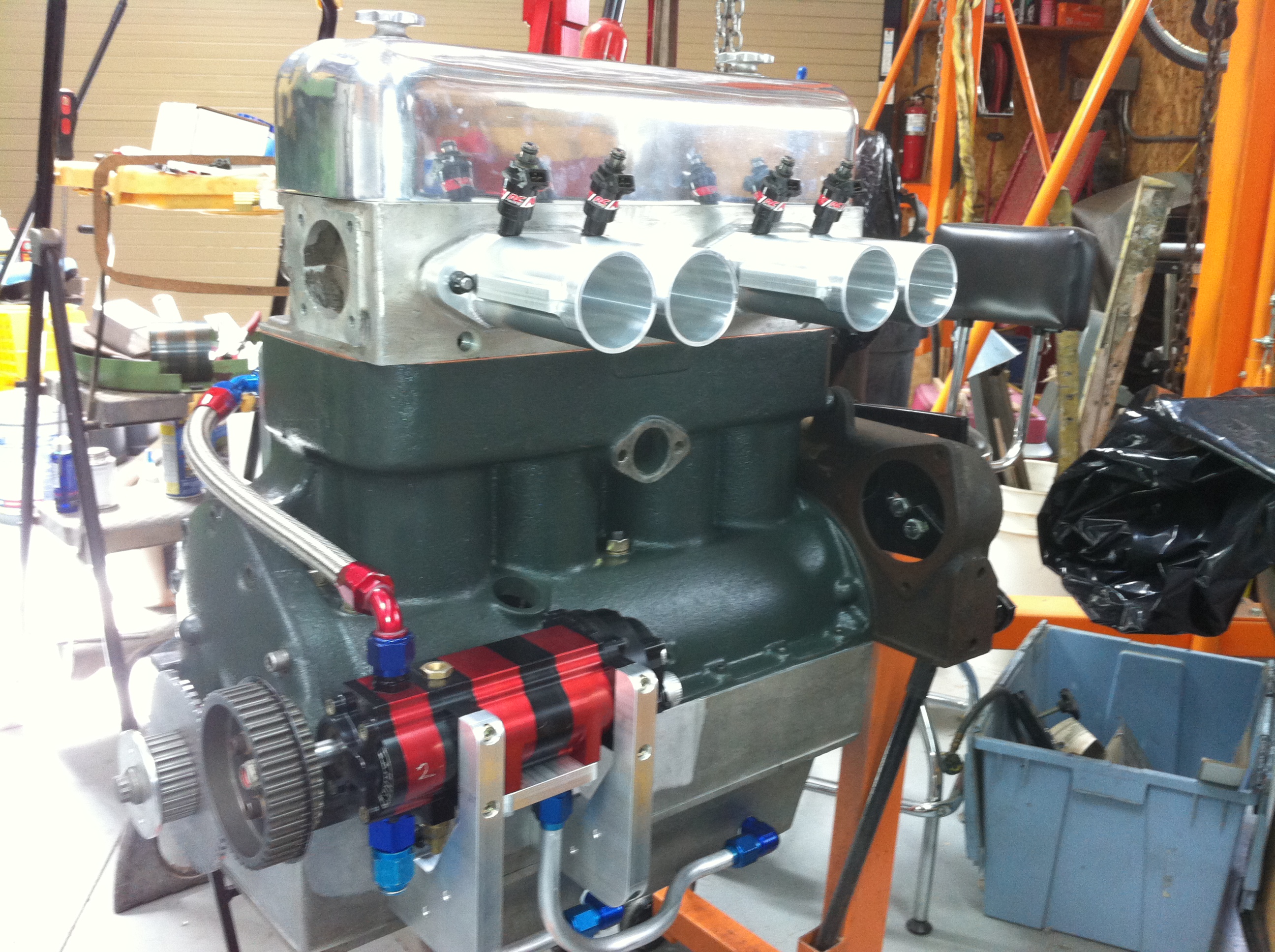

    [​IMG] [​IMG]

    Onething's missing, the camshaft and adjustables lifters, still the original one, where i will can buy these set up for street racing used...

    It's a GAZAL buissonnet high compression aluminum head, a special construction from a french motor specialist who worked for citroen in the 30's, i don't know more about this aftermarket parts builder...

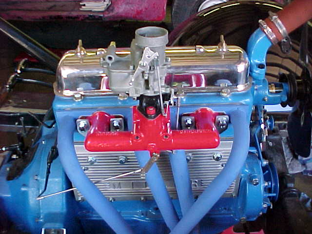

    [​IMG] [​IMG]

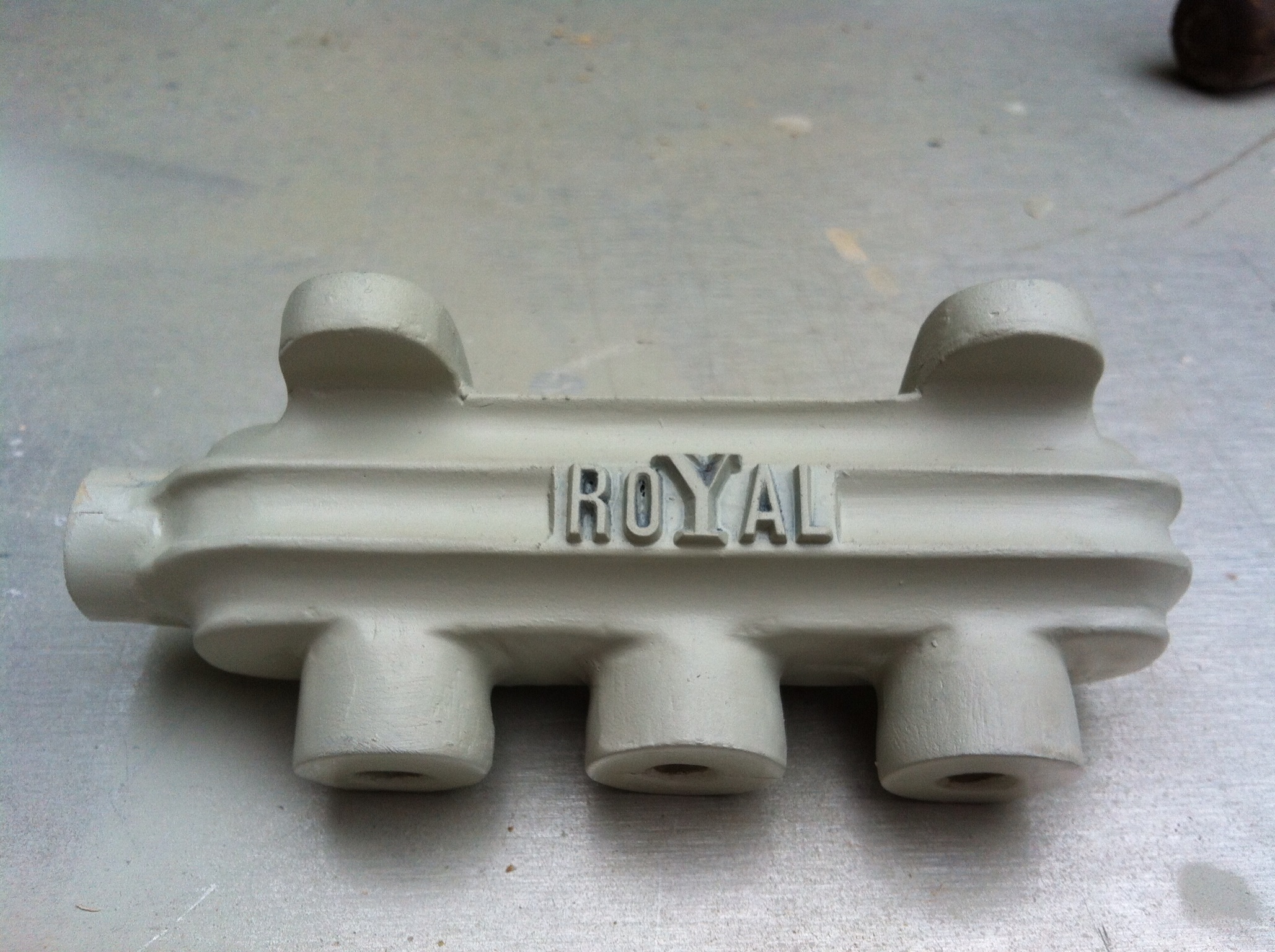

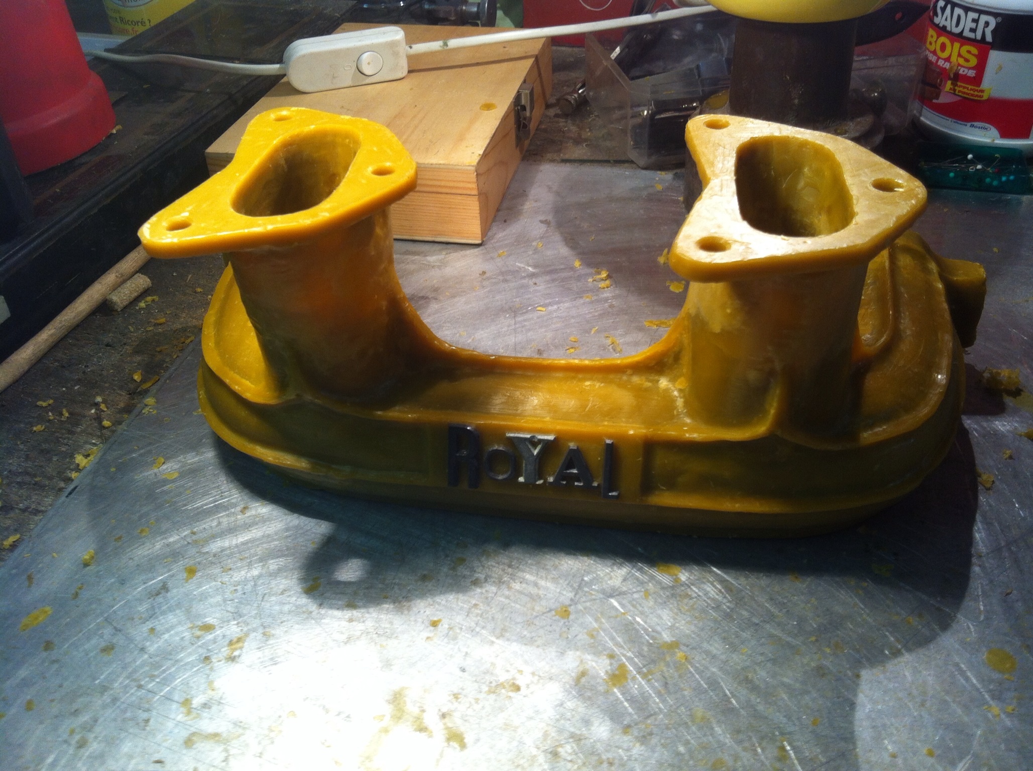

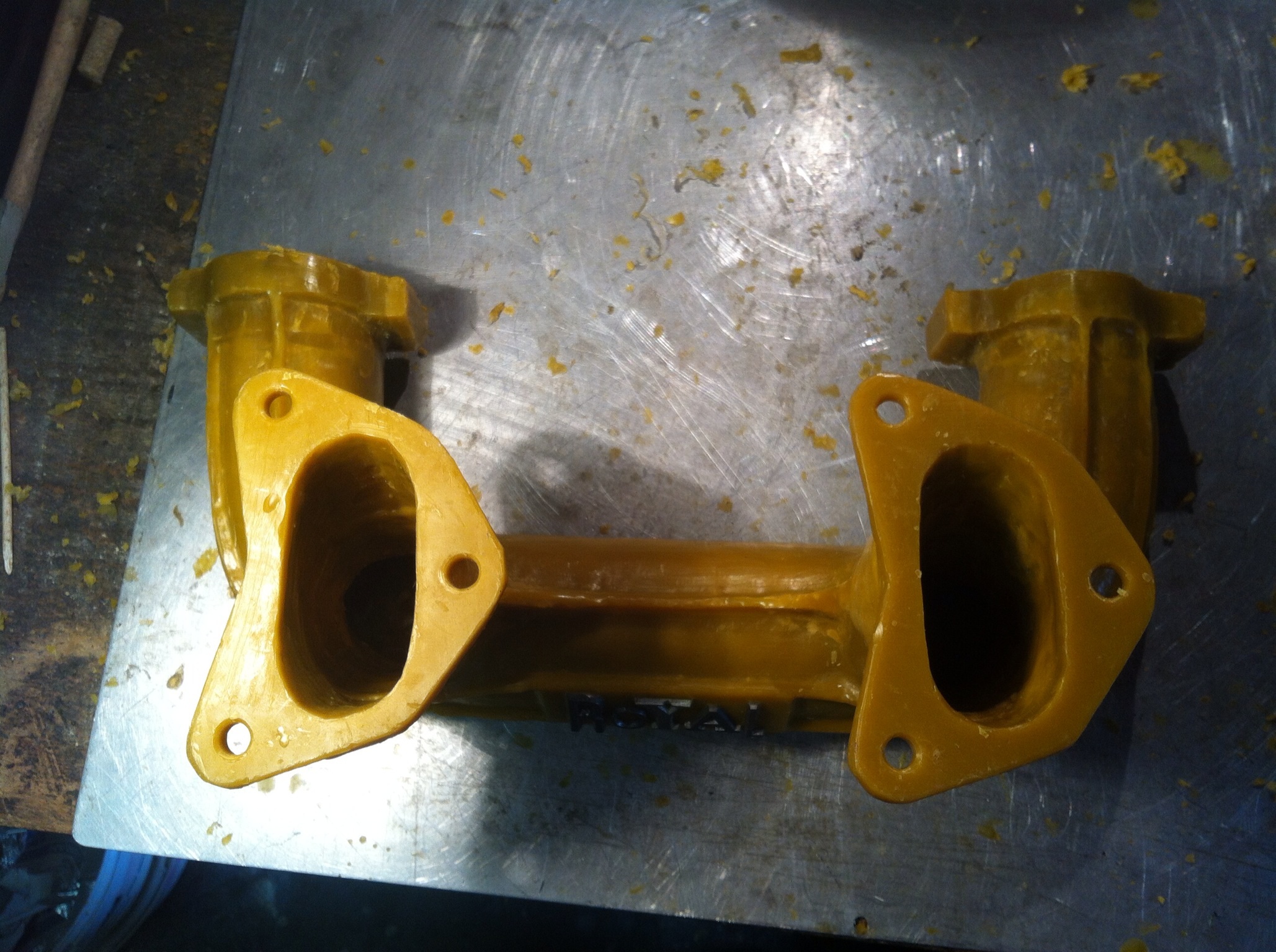

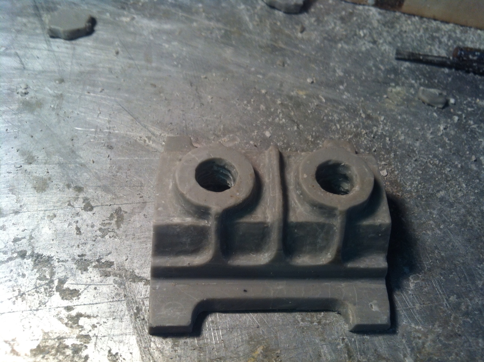

    What do you think about this, i built different molds for the 4 banger, the first is a finned valves cover side for sand casting, the second mold is a dual two's intake manifold in wax for the lost wax shell casting process need finitions but it's sounds good,
    and two small fuel distributors in wax too...
    The furnace is in my backyard, waiting for shell casting stuffs and petrobond sand ( good casting stuffs is hard to find in france)
