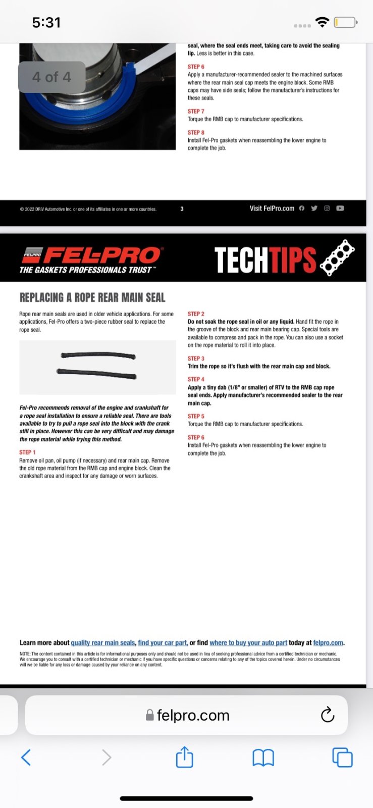

    Posted on the Barn, but so far no response, so thought I would try here. Getting ready to ****on up the bottom end of the block. Purchased a Felpro engine gasket kit, and the machine shop installed the upper rear seal that came with the kit. Looks like a Teflon impregnated rope seal. Not sure if kit came with instructions, but don’t have any. Installed the seal in the timing cover and didn’t trim it, but not sure if I should have. Doing a search on the barn, it seems some day to trim, and others not. Felpro Instructions just mention t******* the upper rear seal so it is flush with the bearing cap and block. No mention of what to do for front or oil,pan. So, should the Felpro Teflon impregnated rope seal be trimmed or left as is when installing it on the timing cover and oil pan?
    As installed on the timing cover without ant t*******.
    Felpro Instructions.

    Spoke to Felpro tech support (Garage Gurus?) this morning. Was told to keep it just a few thou proud of the mating surface. Not sure how one could do this. Asked if they had something they could email me, and was told they have no printed material. Pretty lame. Will leave the timing cover rope seal as is (sticking out about 1/16” which is about the thickness of the cork pan gasket) since the gasket does not sit on top of the rope seal. Will do the same for the section going into the pan. Essentially, that means no cutting of gasket.
