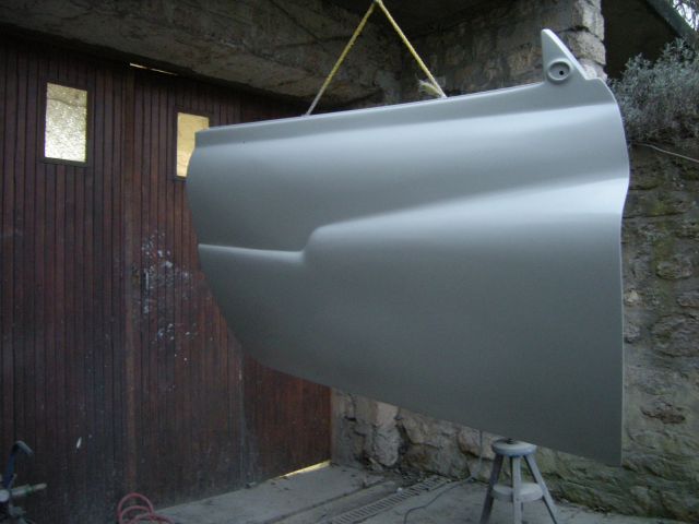

  9. VEDETTE
    Joined: Oct 14, 2010
    Posts: 473
    VEDETTE
    from FRANCE
    Finally once out I don’t like it! the door is too short :(
    I go back to work and pull back the pillar by 7 cm !
    It’s much better this way! :cool:

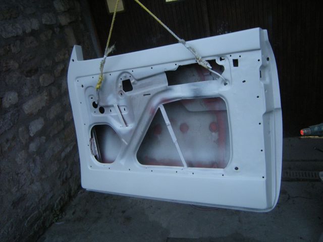

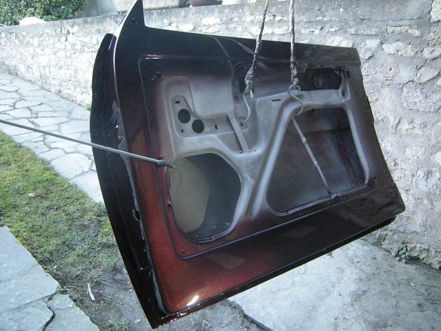

  21. VEDETTE
    Posts: 473
    VEDETTE
    from FRANCE
    Painted interior
    soon spring to paint all this!
