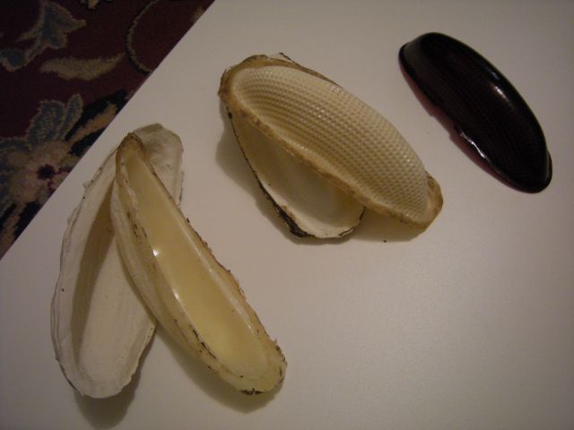

  9. VEDETTE
    Joined: Oct 14, 2010
    Posts: 472
    VEDETTE
    from FRANCE
    The problem with LEE lenses is that the light does not pass correctly because they are too dark and the diamond texture slows down the light. so I remade transparent resin lenses to apply a less dark red candy paint .I think the light will pass better!
    Liquid latex mold +plaster..

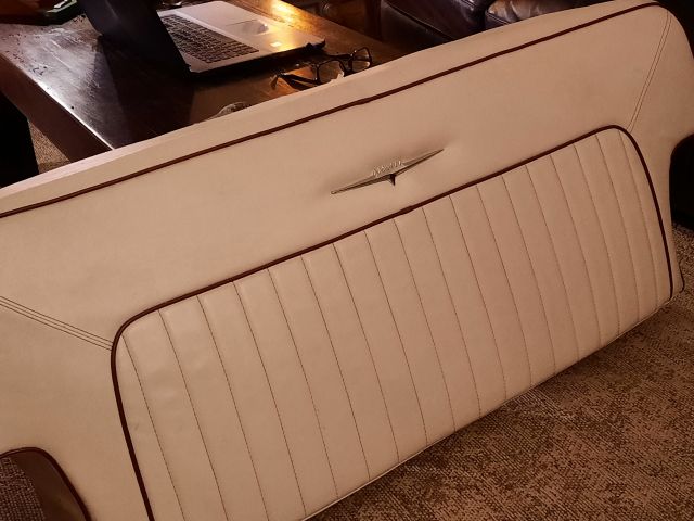

  25. VEDETTE
    Posts: 472
    VEDETTE
    from FRANCE
    While waiting for the beautiful days I made some small coquetry..
    badge inlaid in the upholstery :
    Baby moon:
    and reproduction in resin tinted with my knobs!:
