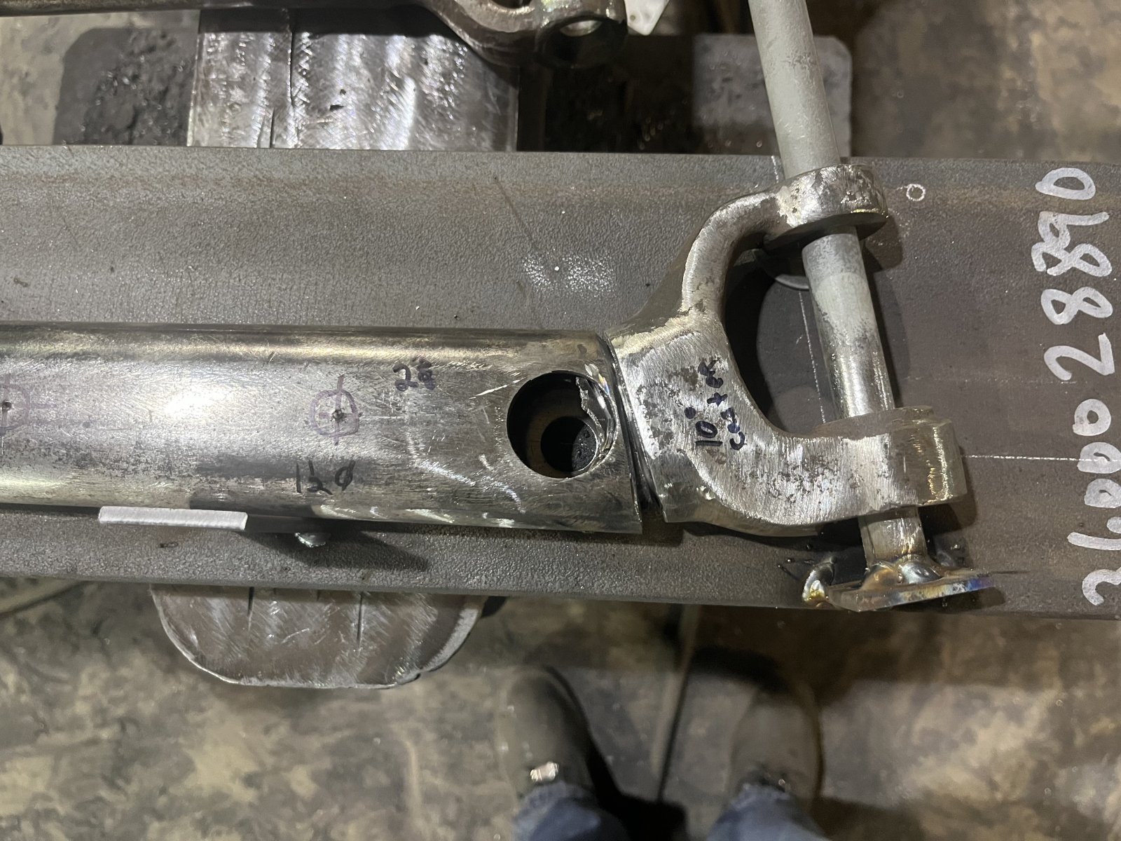

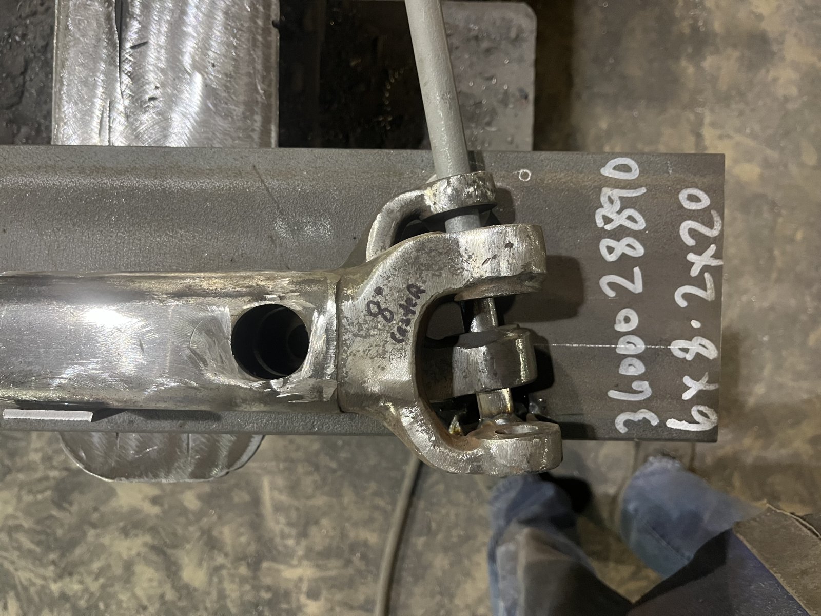

    A57E5B66-214E-48E1-9141-4DE9A5C503EE.jpeg I have a question about how the yoke end of a Ford wishbone is welded to the tube end. Is it just a **** weld or is the yoke partially in the tube like a drive shaft yoke? I need to change the caster because I’m flipping them upside down to lower the ride height.

    F8F9D25E-6A68-4A29-B2C3-4272BA7E344F.jpeg 2BCEF180-DA49-45D3-B2A6-920A32A914D8.jpeg Thanks. Yes the yoke extends into the tube.
    By flipping the yoke and adding 2 degrees more caster, it lowered the car another 1-3/4”.

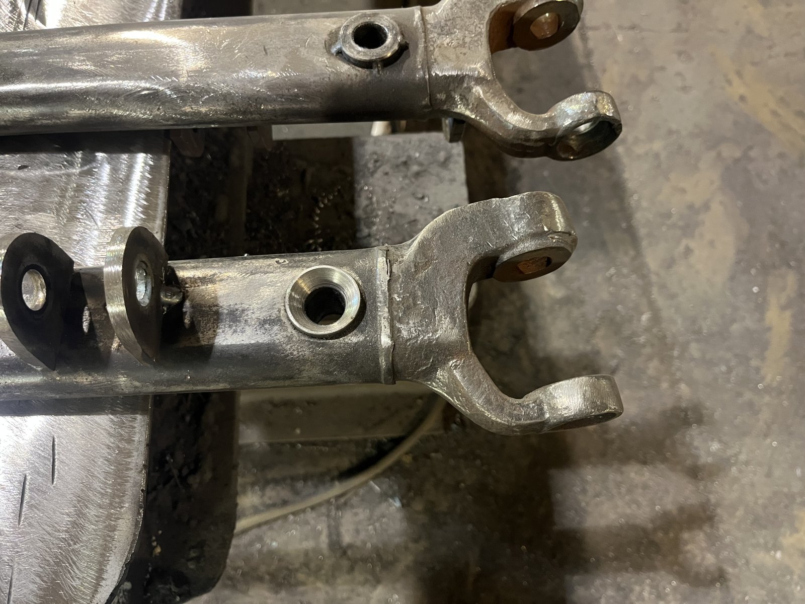

    the forged pc has a bung that fits inside of the tube. 20200915_212405 (1).jpg

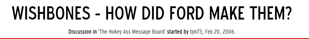

    Look up this thread and prepare to get educated.
    Illustrious Hector likes this.
  21. 65standard
    Joined: Jun 14, 2011
    Posts: 1,096
    65standard
    Good information. Thanks, I added the link

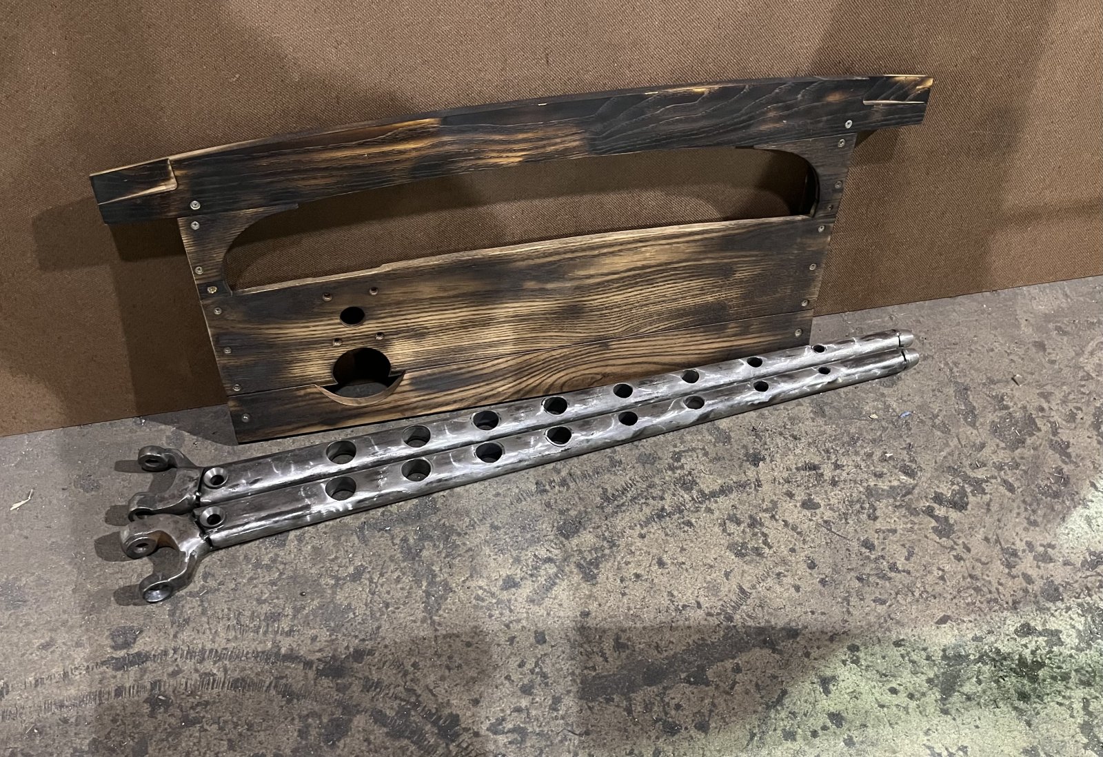

    0918B2AF-1208-4373-9CD3-039A3E2F8DBC.jpeg Wish bones are ready for welding
