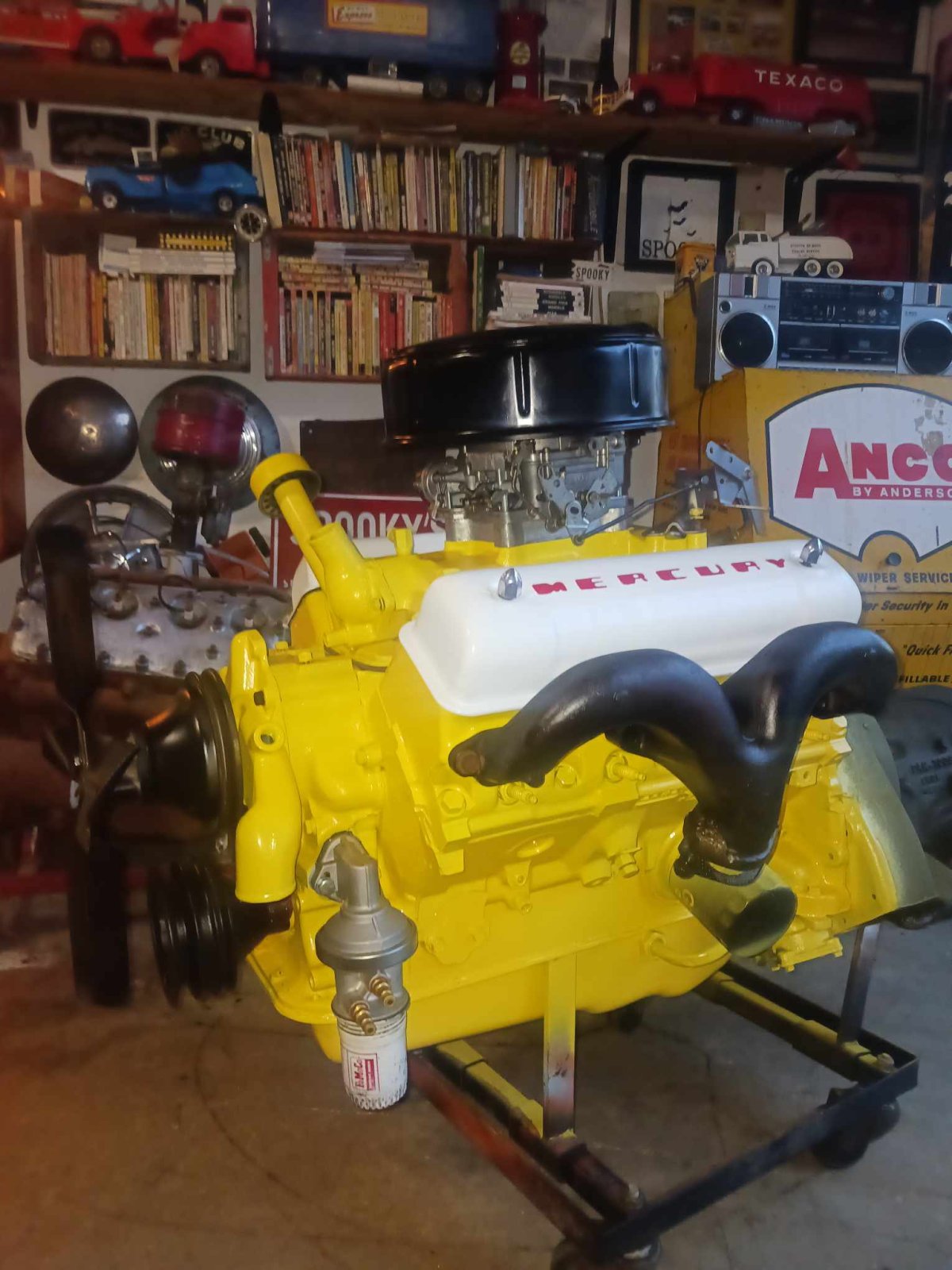

  4. Spooky
    Posts: 2,534
    Spooky
    :D-I was so stoked to get those!!! upload_2024-6-7_15-35-44.jpeg

    Joined: Dec 9, 2008
    Posts: 3,488
    AVater
    Had a pair then realized 1 has a hole/crack right in the crotch. Poor quality cast is best I can figure. Dissolves quickly when heat applied.
    Your engine looks beautiful! Love the Mercury valve covers
    Spooky and OG lil E like this.
