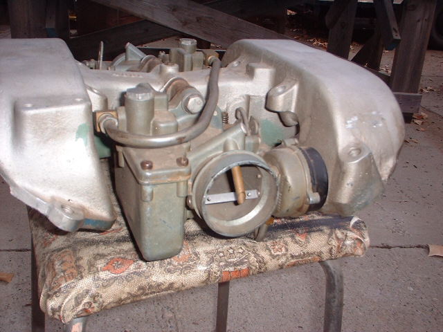

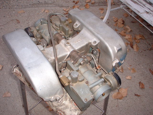

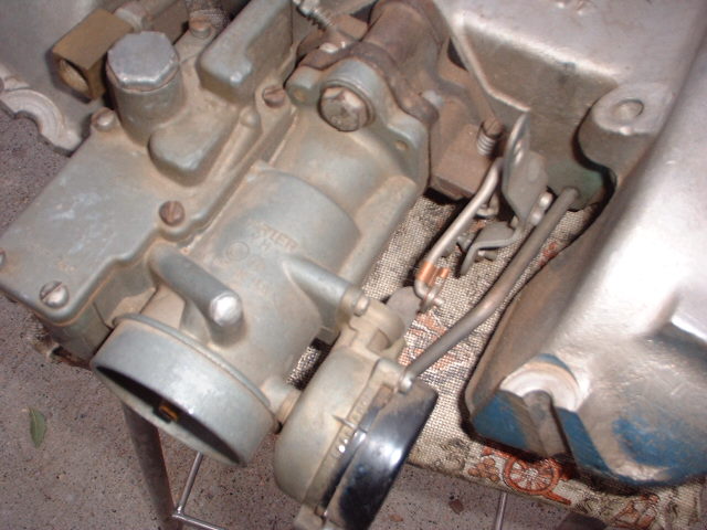

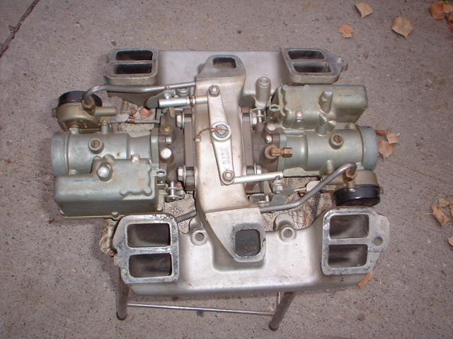

    My new swap meet score is a Y block marine intake manifold with 2 carter YH sidedraft carbs. I found some info on the carbs and some on the manifold on a google search. It seems I'll have to build a water crossover/outlet which doesn't seem too big a project. Anyone have a picture of this on an engine or experience with them. They were on the "Interceptor" marine engines-292 312 Ford Y block. I picked up a running 292 2bbl engine for the next project and this looks like a pretty cool induction set-up.
    Any info or help appreciated.

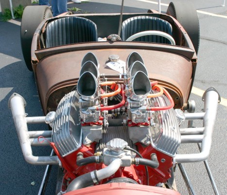

    you can do this also and pipe tap the holes in frost plug holes in the heads and buy or build a t-stat housing

    here ya go
  8. overspray
    Joined: Jan 14, 2003
    Posts: 1,447
    overspray
    Zimm, is that yours? Is that store bought or home made? That would even work better with the aircleaner idea that I have in my head. The forward mount would give more room. The water doesn't care where it goes, as long as it goes without too much restriction.

    not mine do a yblock serch and you will probly find it i wish it was mine

    That set of heads didn't have water jacket plugs-those holes are drilled and tapped directly into the water jacket. That plug on the left hand head (Right in picture) fills a mistake. I guessed wrong on where I could get into the water jacket without screwing something else up and got into an oil return passage. Had to sleeve it and plug the outside. Engine runs cool with only 3/4 pipe outlets (1" hose to the thermostat/fill housing.
