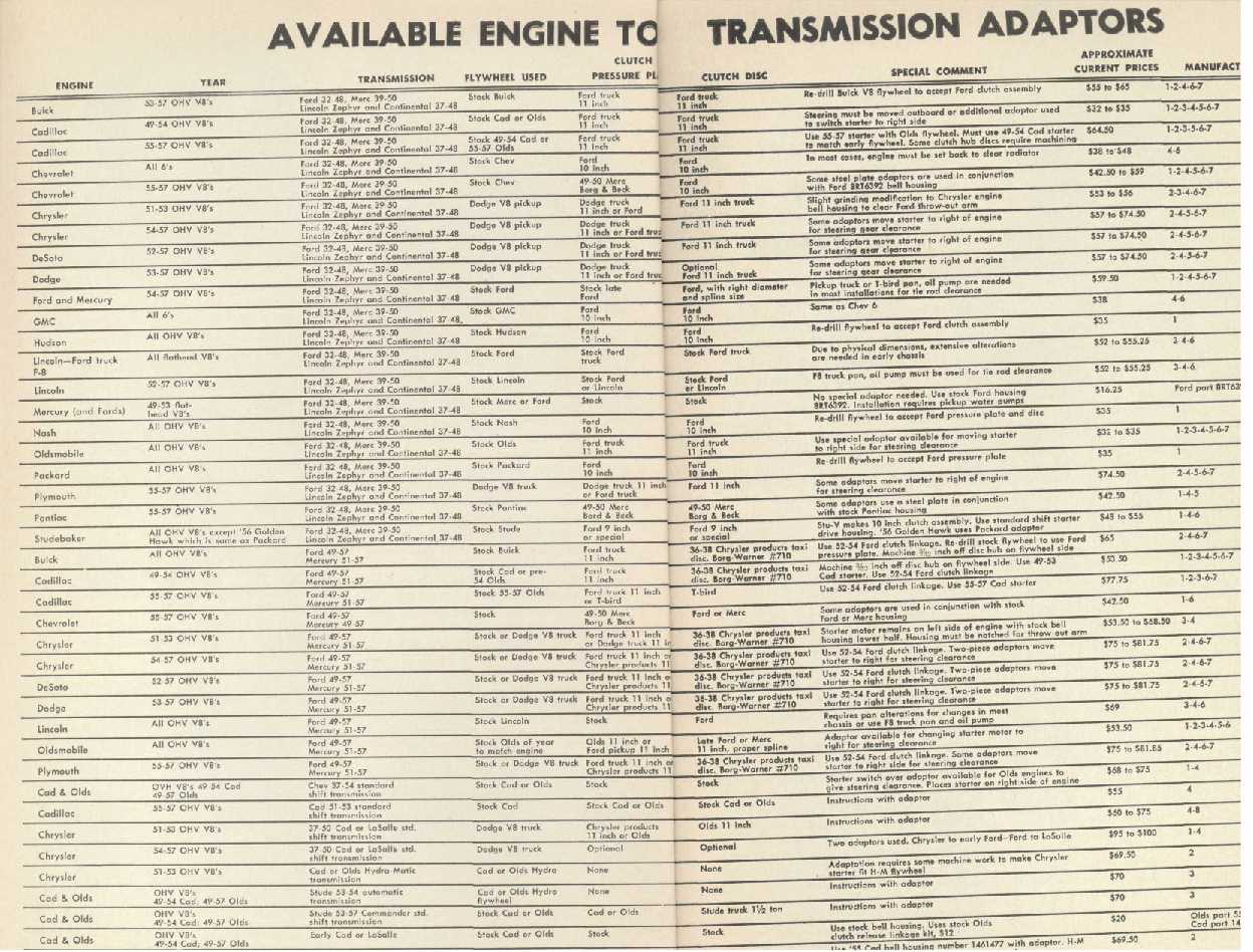

  5. I've posted these a couple of times before.
  6. Some other useful info on the swap from the 1958 Hot Rod Annual

    Thanks 39coupe. This is exactly what I was looking for.
