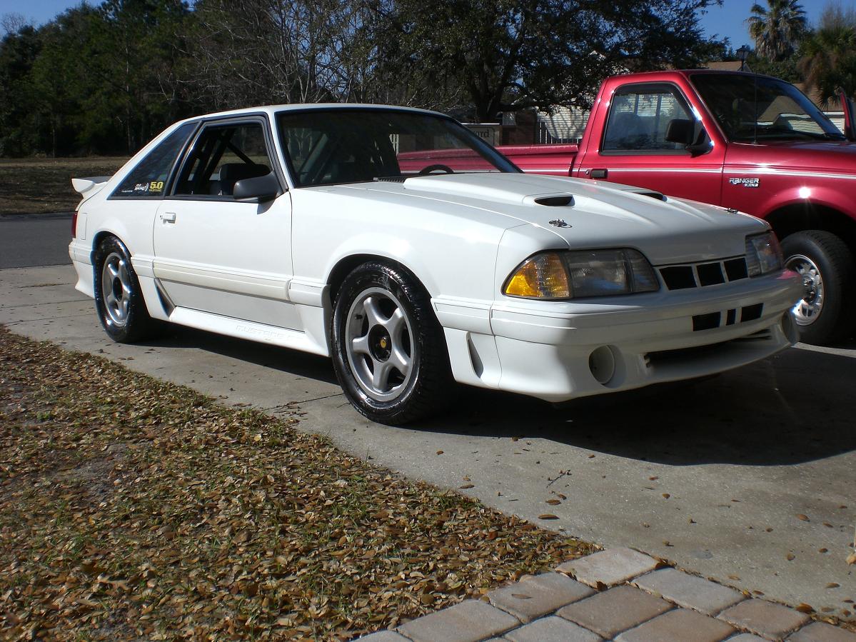

    I bought this one for the 347 A-4 block ported victor jr heads then took it apart for my coupe.
