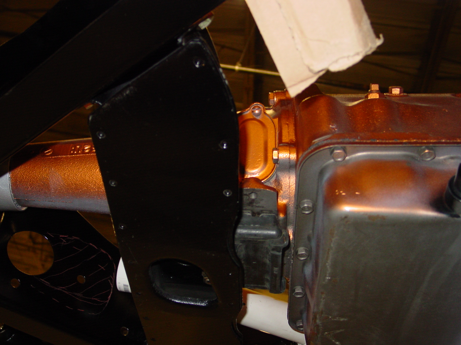

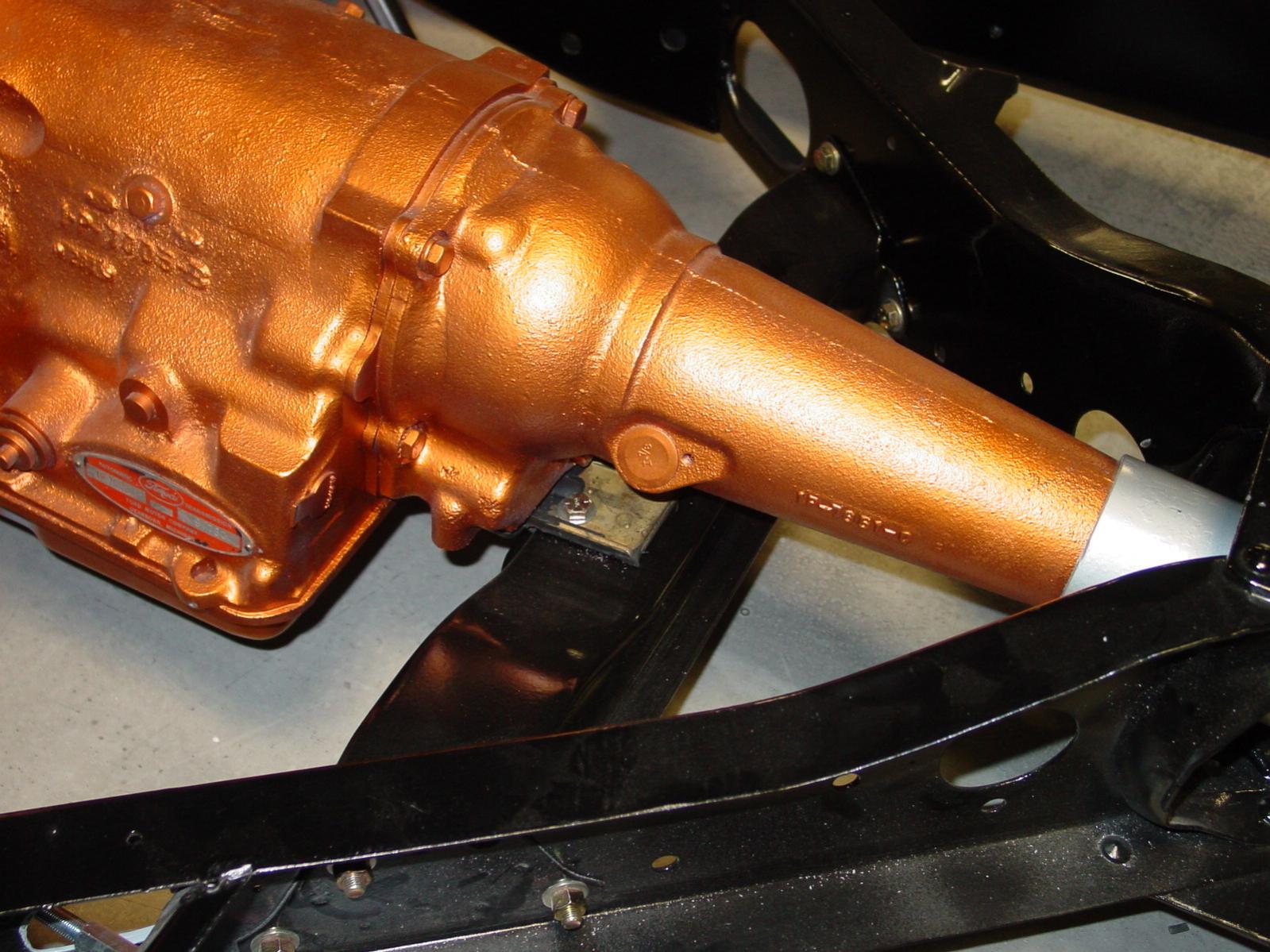

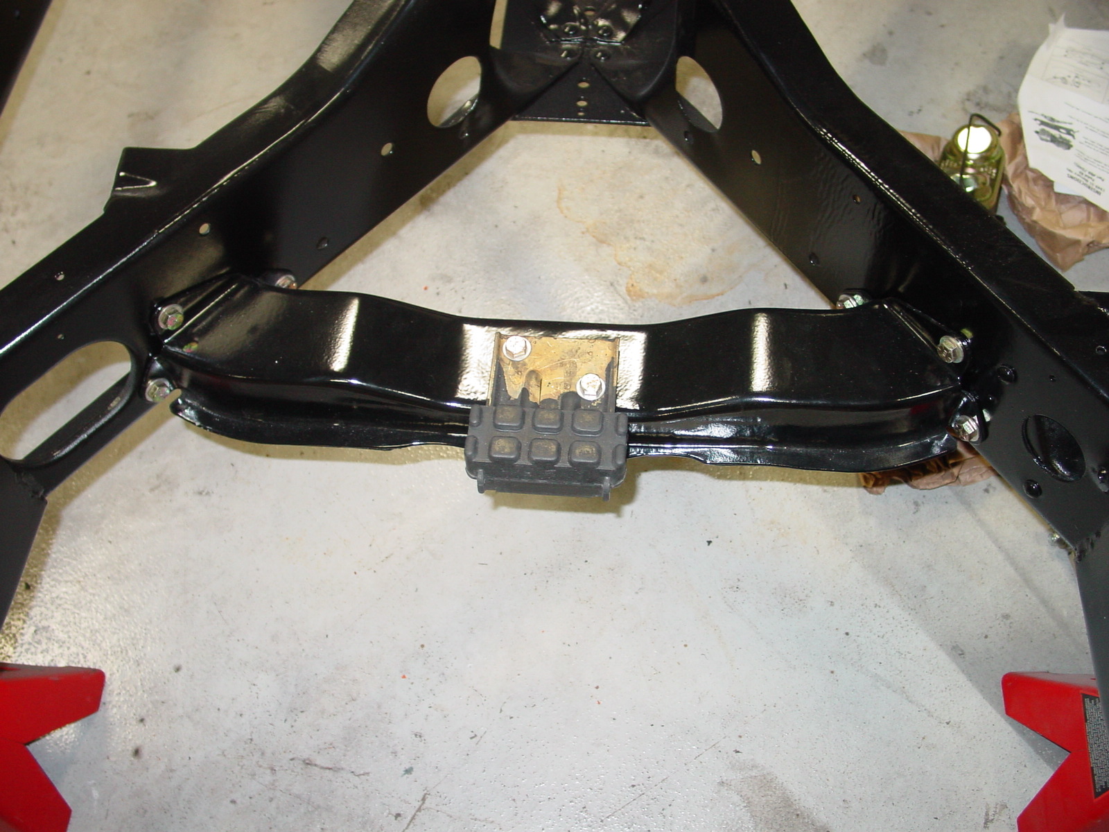

    I have a Merc-o-matic, and from what I know, a Mercomatic and Fordomatic (and Cruise-o-matic) are the same transmissions. I believe 1951 through 54 Merco/Fordo were the same, considered a small case. In 55 they offered a small or medium case. Also, a 51/52 Merco/Fordo probably has a drain plug, where a 53/54 has a dipstick tube in the same spot into the pan. A small case has a different pan and gasket than a medium case.
    http://www.tocmp.com/manuals/Ford/1958/Service/04/FordOMaticandCruiseOMaticT/04-002.html
    http://www.autotran.us/fmkits1.html
    These pictures are a 1951 Mercury with a 53/54 Mercomatic. I'm assuming your trans mount should look the same, even if the crossmember is different. I have another Mercomatic, a 51/52 that also has 1P 7000 A cast into it.

    I just finished adapting an extra vert cross member I had to fit the length of the tranny. Turns out it is roughly 1.125 longer than stock I checked my motor mounts to make sure the are not backwards and the seem right. The extra length seems to be in either the case or the bell housing. If the tranny was out I would be able to get some accurate measurements. I will probably need to have my drive shaft shortened while I'm at it. I don't mind doing these things as long as they actually need to be done and I am not just screwing up. The previous owner is diseased and he bought the car as a runner and the took it appart 12 years ago. His sons tell me he never did like the tranny it came with but could not tell me if he replaced it.

    Interesting how the Mercomatic has a similar side cover on the tail housing as the Lincoln hydramatic does. Wonder if it is there to access a snap ring as the hydramatic has.
