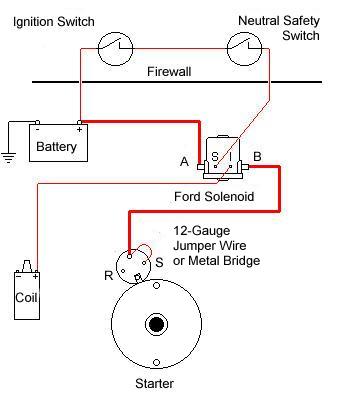

    upload_2024-12-30_8-11-55.jpeg The “I” on the starter relay is for Ignition. It’s a BYP*** CIRCUIT, byp***ing the ballast resistor or a resistor wire to send 12 volts to the coil. Be careful if you remove the starter relay, you will lose that option. When a Hitachi reduction starter is used there is no BYP*** feature on it solenoid, like the Ford relay. The circuit diagram provided by Kerrynzl doesn’t show the power from ignition switch but clearly shows the byp***-Thanks Kerrynzl . Watch out for feedback, starter will stay spinning while engines running. I for Ignition or I for ISOLATION. Not sure how your car is wired, so I blurted this out regardless. HAPPY NEW YEAR

    Thanks for the wiring diagrams,
    There was not a wire connected to the I terminal on the firewall solenoid so I’m not loosing anything there.
    The car has been wired this way for 10 years and hasn’t had trouble starting so I’m not going to worry about it.

    Most Ford Starter Solenoid/Relays the "I" post is Dead as a Dodo unless the solenoid is activated [cranking] so there is no back feeding [it doesn't hurt the ballast because there is 12v each side when cranking]
    I have seen DIYers mistakenly think the "I" is ground because it appears to go nowhere when tested with a multimeter [that causes a bit of fun]
    Chances are the early Ford ignition switch has 2 coil feeds [one is "run" going to the ballast, and the other to the coil for starting]
    55-56 Chevys are like this, but I am not familiar with your Ford [somebody with more wisdom can chime in here]
    On 57 Chevys ,they rely on the "R" post of the starter to supply 12v the coil when cranking , But when you install an aftermarket starter [eg: Hitachi or Denso] you splice a wire from the starter "S" terminal to the coil BUT you add a diode so the coil doesn't back feed to the starter while the engine is running.
    If your starter is working fine as is [and starting] ........... leave it alone

    You’re right. The “I” terminal byp***es the ballast resistor for starting. The Ford switchs (at least in my 55) only had power to the solenoid in start. The “run” setting was the ballast resistor and accessories.
