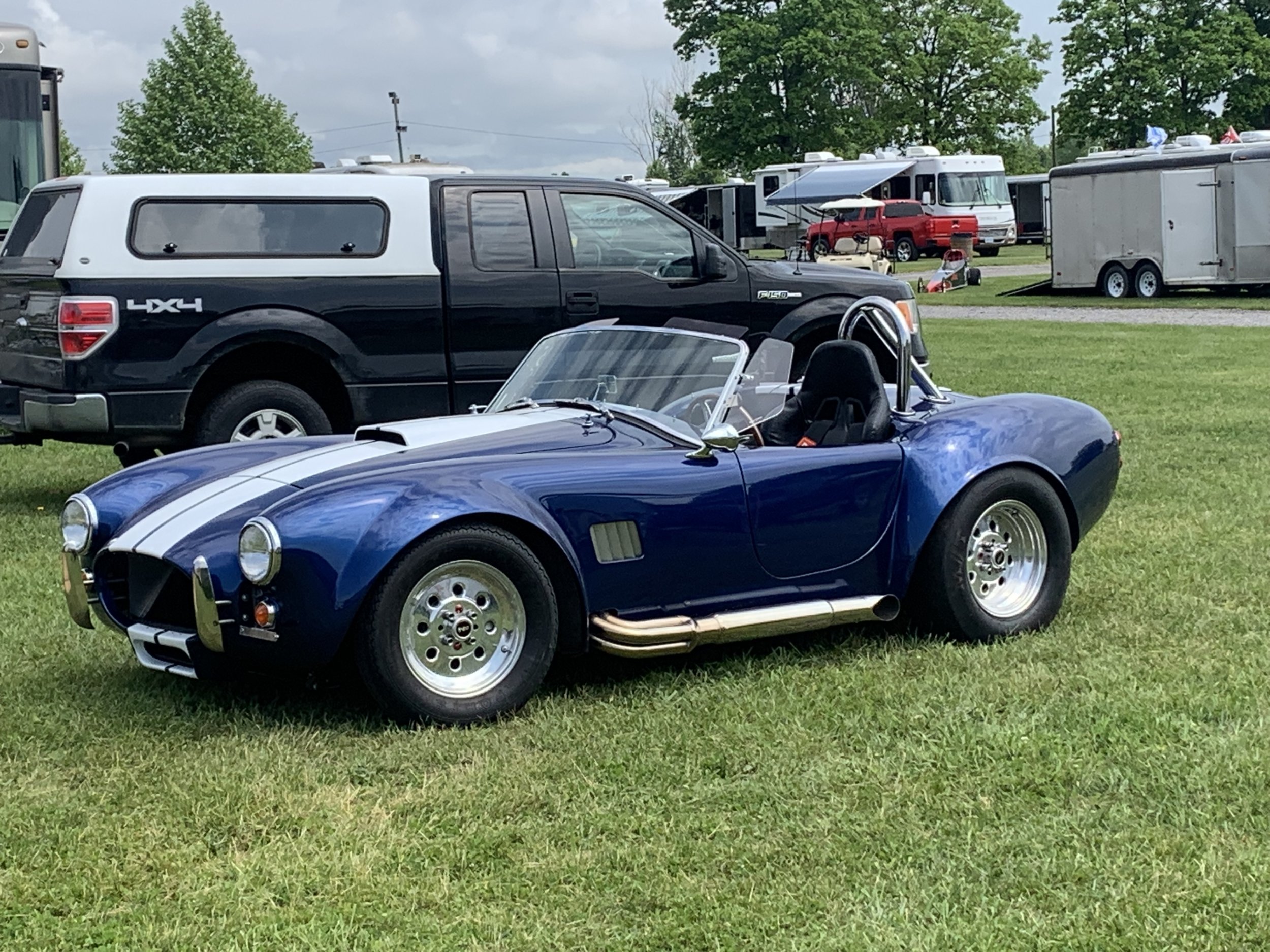

    If I want to violate the town noise bylaw I have this other car:
