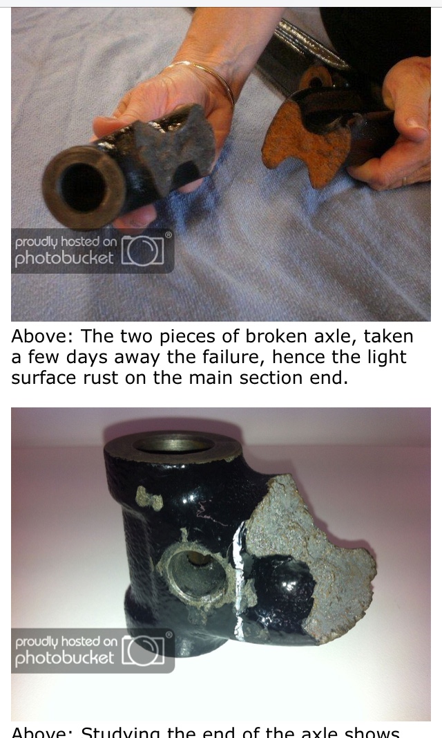

    They do indeed use cast iron, the axle above was new, broke in his driveway after the first drive. Avoid cast axles, you can buy forged axles and original axles why trust your life on something else? Yes people use them and they haven’t broken, what happens if it does?
    Cyclone_racer and land like this.

    That looks hideous. I don't have one of these axles, but having seen cast axles advertised I ***umed that they were made in a non-brittle material like ADI (Austempered Ductile Iron)

    I have seen multiples of broken ones like that.
    And it has been discussed multiple times on the HAMB too.
