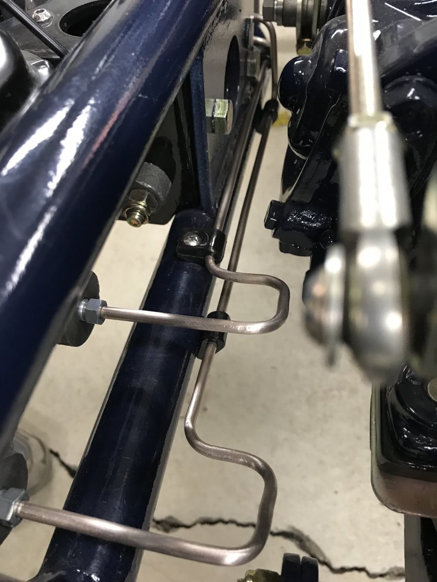

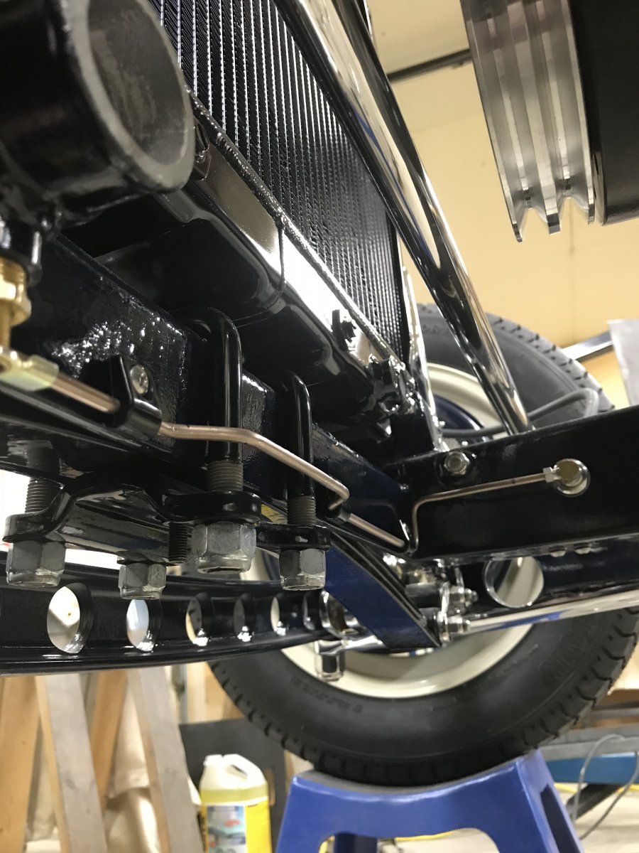

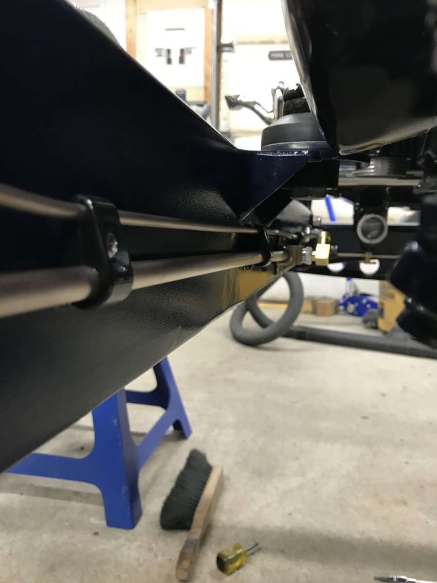

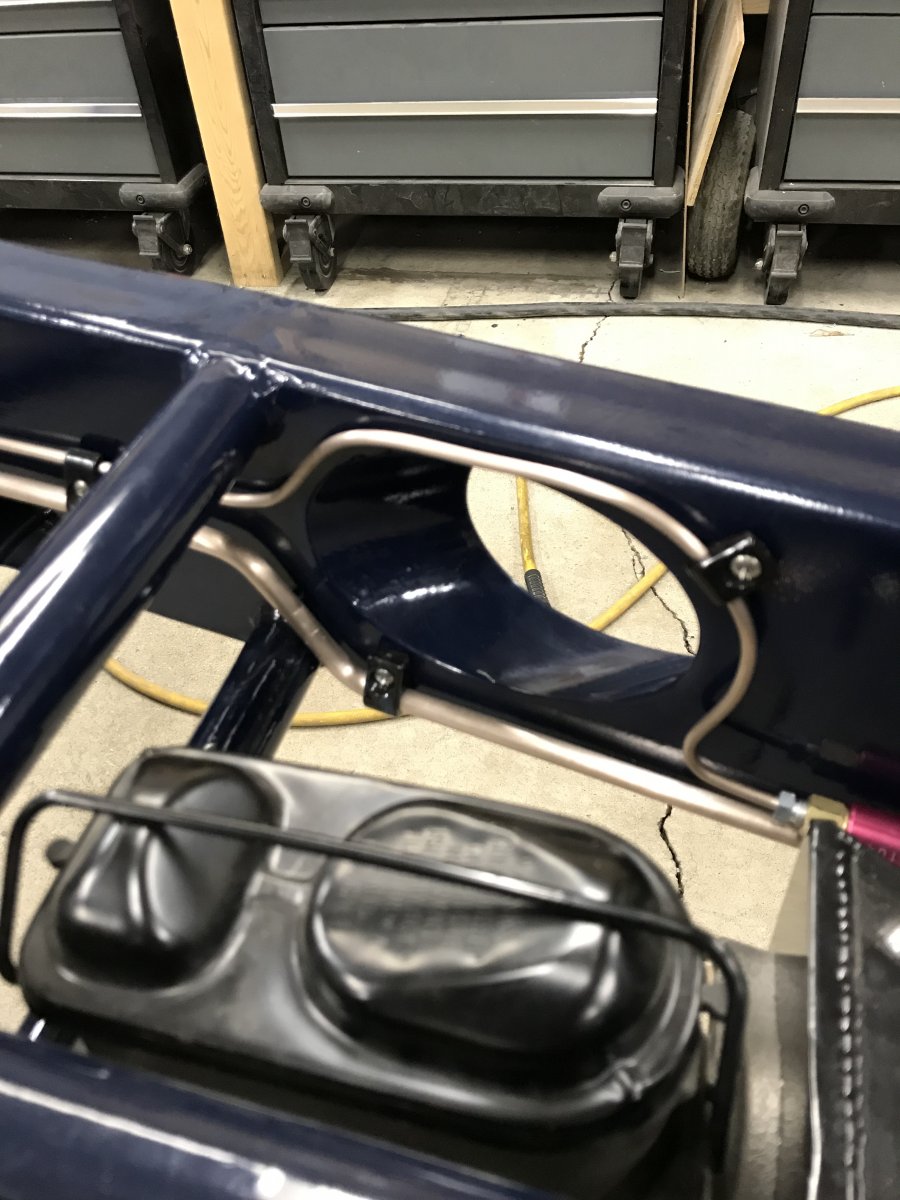

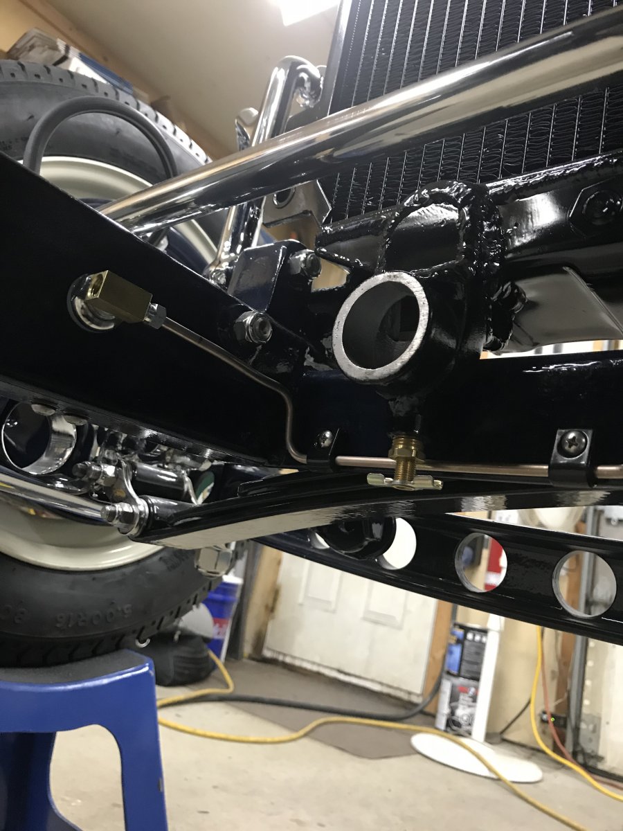

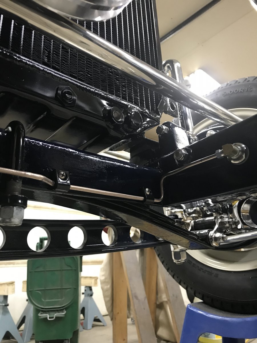

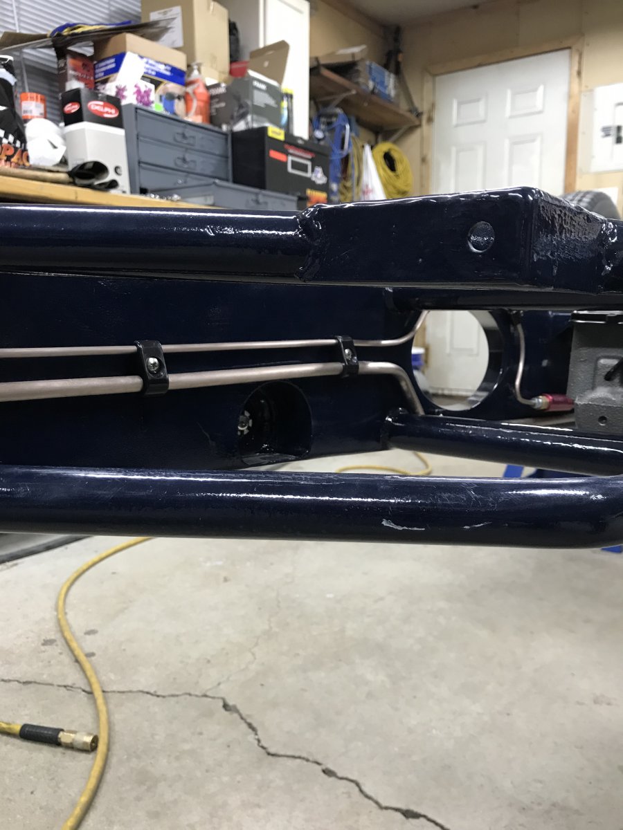

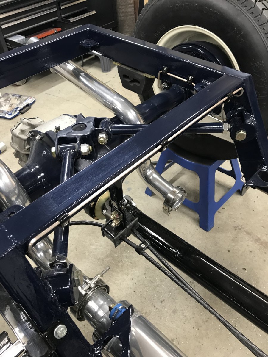

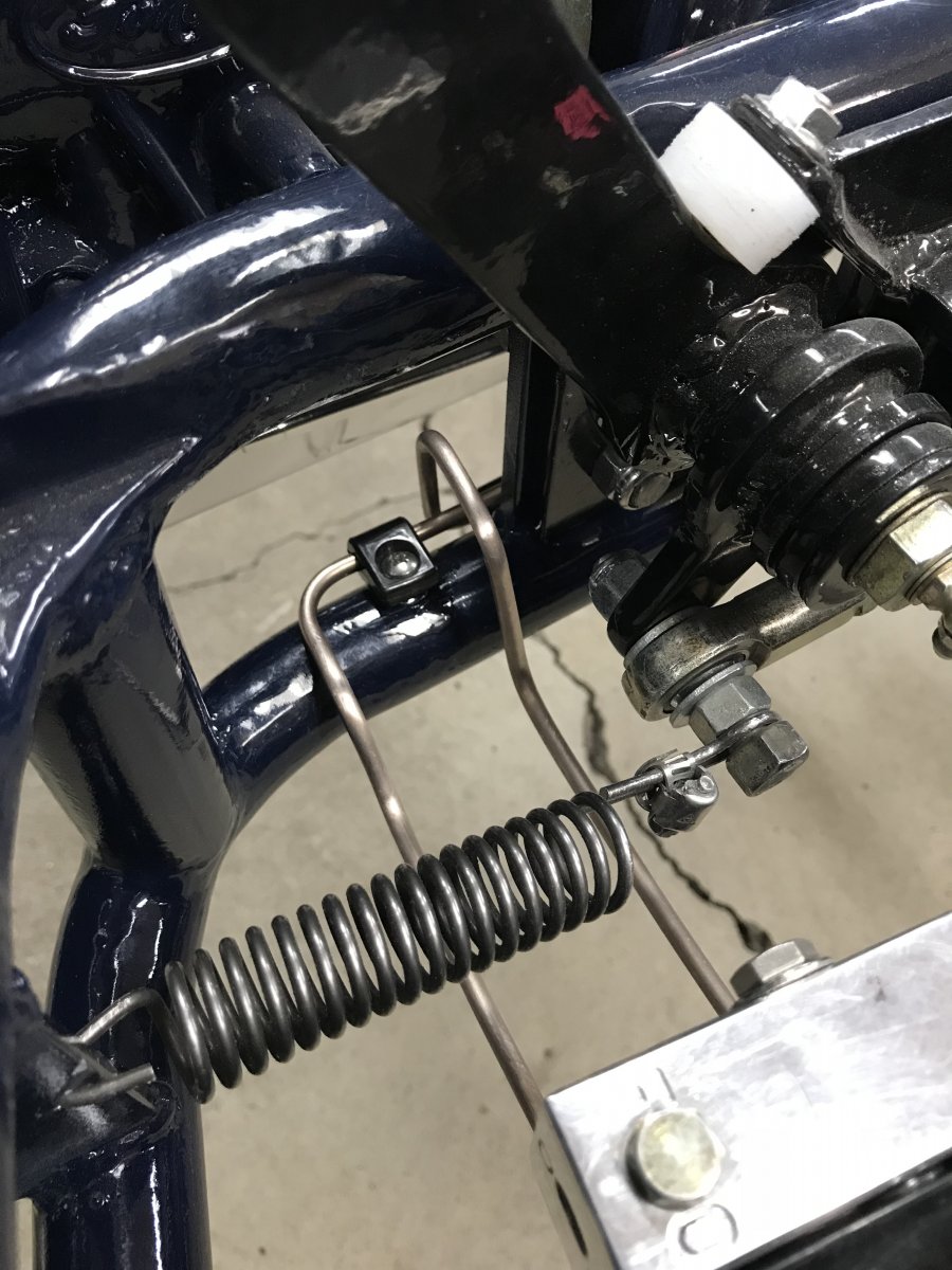

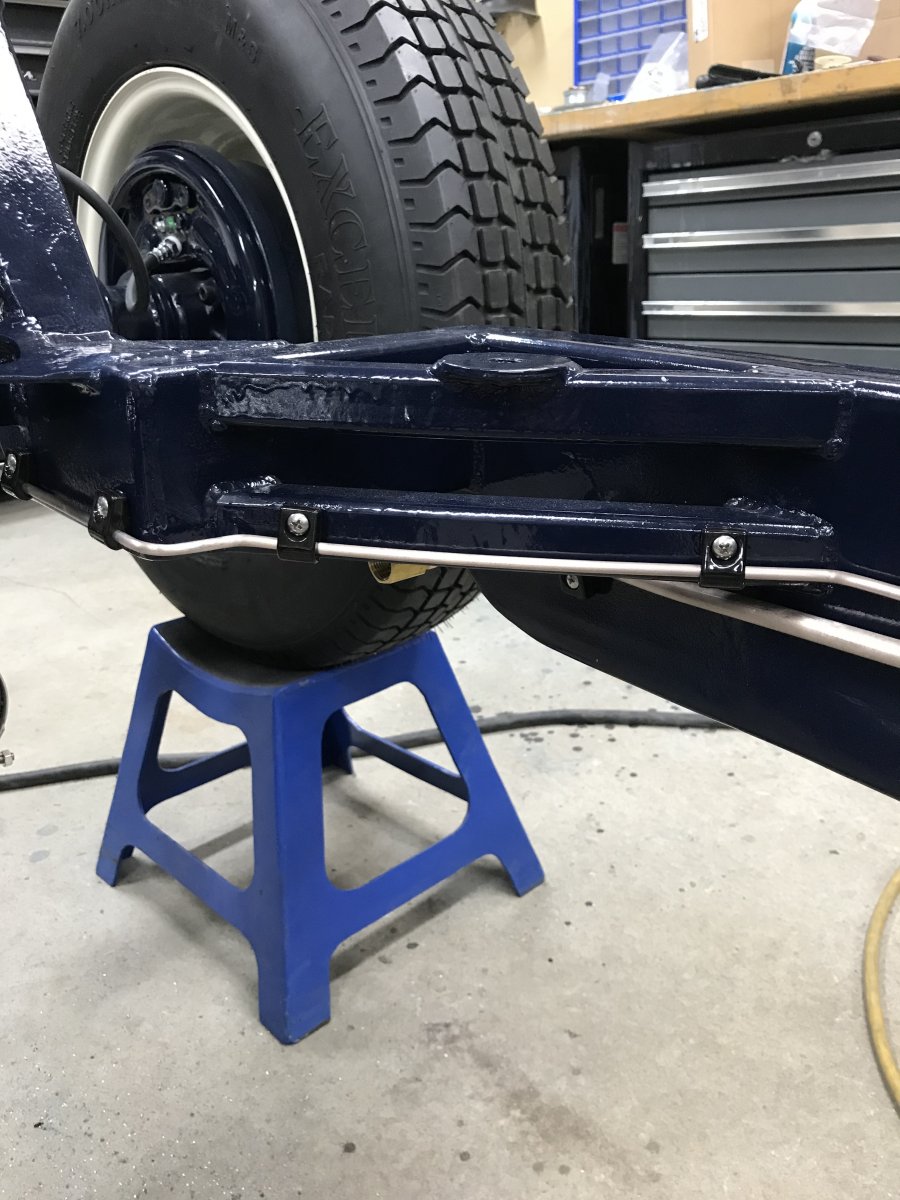

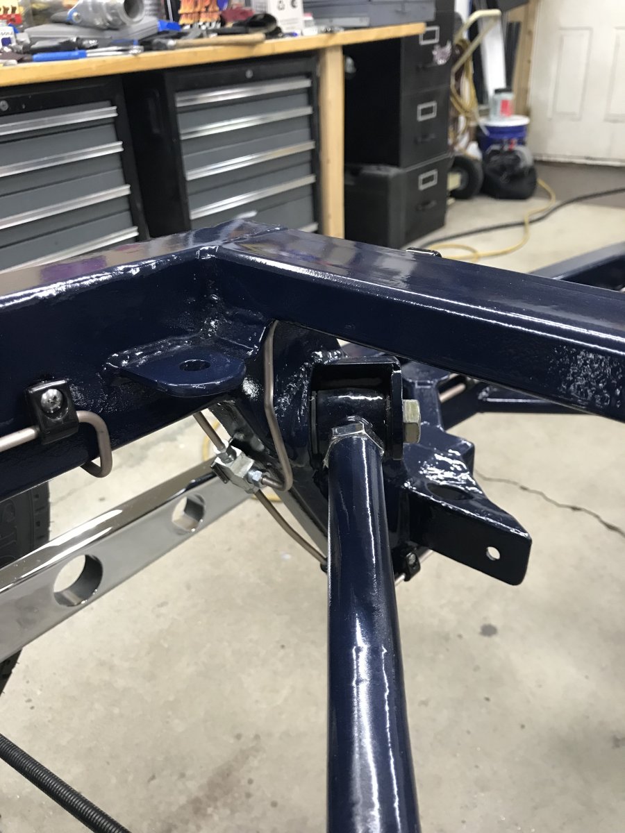

    Yes to the tubing straightener and also yes to some good quality benders like the Imperial lever type benders I have.
    Some random shots of my brake lines all done with ni cop.
    433F147D-DA8E-49CA-9BBD-D9DE632B59DE.jpeg C74A2A52-F0D1-4B26-A6F0-468FA322B4C3.jpeg CC4A5436-191B-42B7-8594-83220F8372AB.jpeg 5A8B0CD0-2737-4BC9-96E8-357FE6848473.jpeg 68A70FE4-4599-4746-99AF-DB1988E79623.jpeg C6846834-57E2-4EA1-824B-5259EA0AA15B.jpeg 5054D0B5-8EE1-4E43-8A16-84CFDA2C8E66.jpeg BC6EE92D-810E-4BEC-A194-2DF78C0CAC15.jpeg 1C9E116E-FB12-4733-B0A9-B59B0E2EA71A.jpeg 677883B5-2239-4BDC-8F95-20FDF494AC37.jpeg 719FFFA7-8B9C-480A-B9F3-7DFD98174C69.jpeg 3D7B7C1D-57F6-4618-BEB9-3CB0F41E69A3.jpeg 4F568F76-AA9A-47A1-BC89-3A399D337F83.jpeg

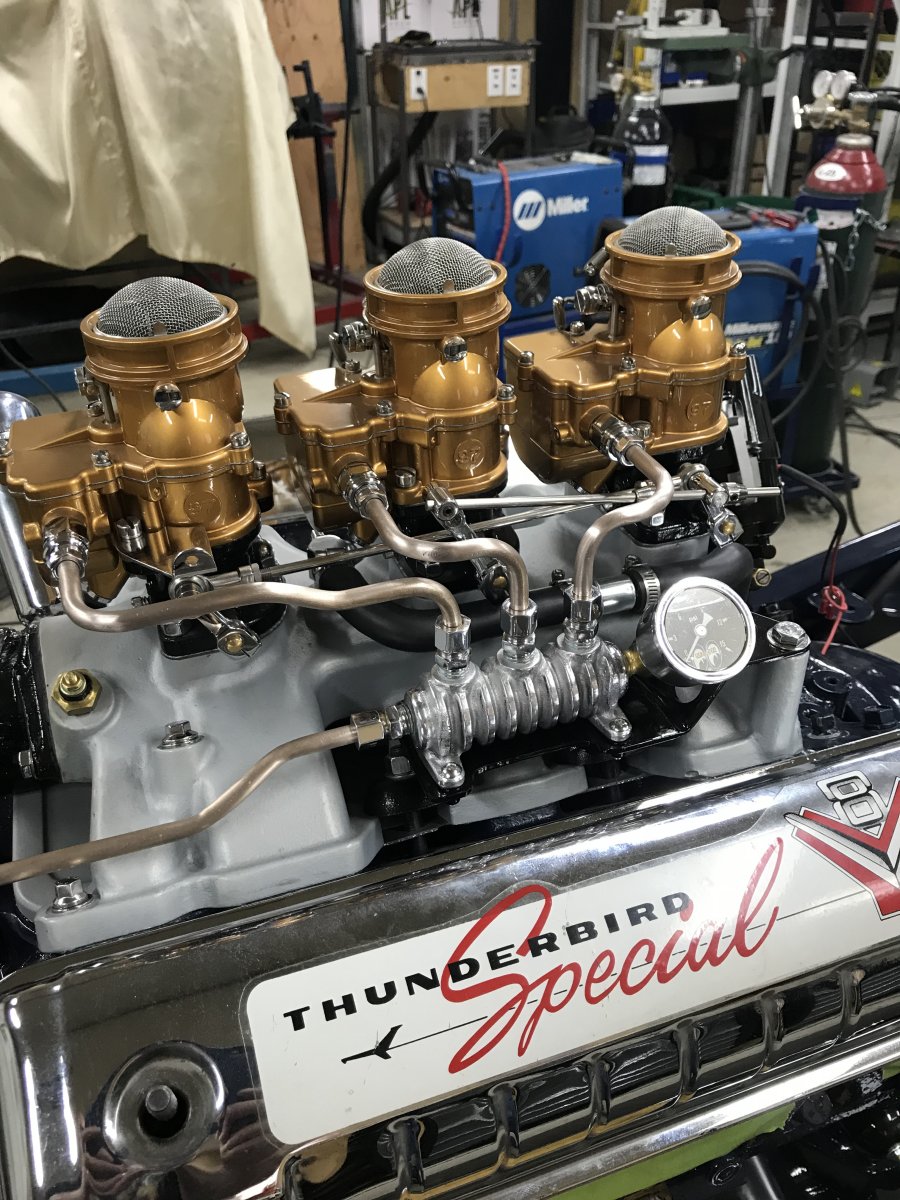

    Very nice tubing work. What is the source of the clamps?
    I ***ume the larger CuNi tube is for fuel?

    Thanks, they’re called T clamps from Made for you products.
    Really nice product. I used them all over my ch***is for everything from the brake lines to the battery cable.
    https://www.made4youproducts.com/t-clamp
    Yes, the 3/8 ni cop is my fuel line.
    I also used 5/16” ni cop to plumb my carbs.
    8590B818-29E4-4EE9-AFB7-A239C0593C70.jpeg 50DD9F47-2F11-48DD-AE19-E9603E8CE318.jpeg 767570EC-DDA0-42E3-AAFB-5FDF3C314EA5.jpeg DC36EAE4-81F1-4C09-B4FF-594CA6877D15.jpeg

    What did you use to secure the lines to the frame?
    32SEDAN likes this.

    I used T clamps from Made for you products.
    They’re mounted in the ch***is using the 10/32 stainless steel machine screws they come with going into 10/32 Rivnuts installed in the frame.
