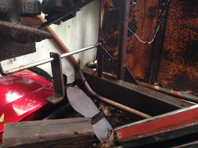

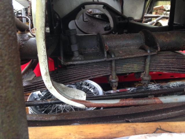

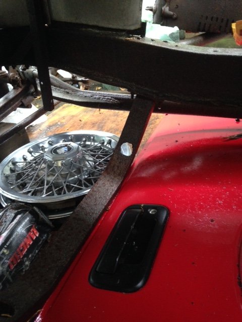

    Where is that last thing mounted? Looks like a hand pump to pressurize a gas tank but the car looks way too new to need that. Frame looks Chevy/GM to me based on the upside-down U shape instead of a C-channel that most Fords used.

    That is what the owner said "for more horsepower..."

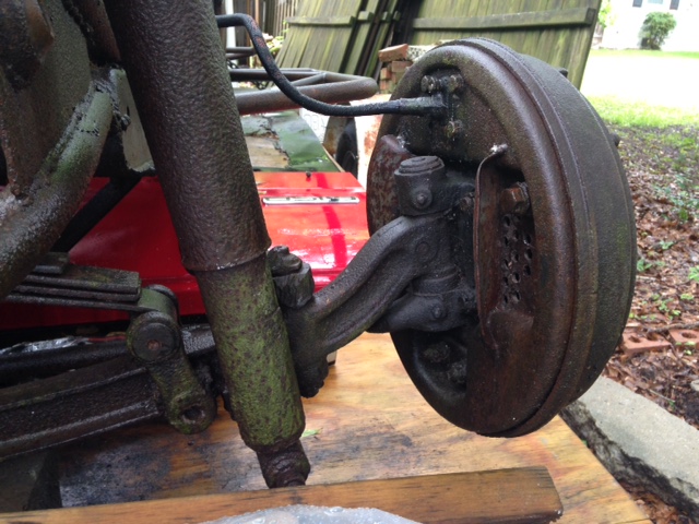

    Interesting front set-up. I noticed the dead perch on the left with the weight jack and drag link on the right. The model A spring in the rear says it probably had a quick change. It was likely a serious race car at some point in its life. Definitely someone put some effort into its construction.
